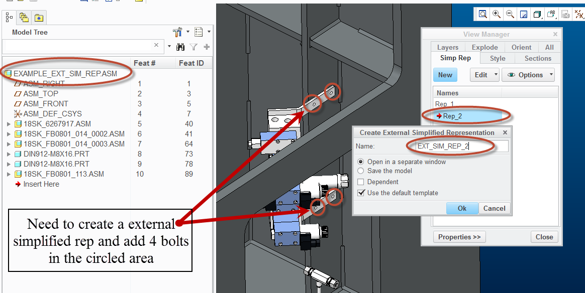

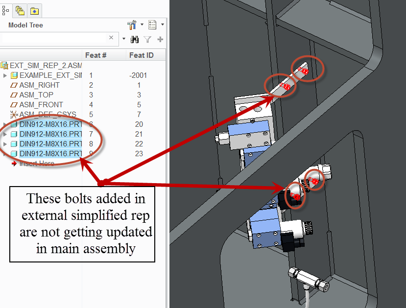

I am trying to add the component in the external simplified rep but the added component is not getting updated/visible in the reference assembly.
I am just trying to check if concurrent modeling is possible with external simplified rep.
It will be of great help if any one can solve this problem

I am interested to know if it is possible for multiple engineers to work simultaneously on the large assembly.
Assume each engineer creating the seperate external simp rep and works on it independently and finally checks into the common space then will the changes made ( like component added or change in constrain type) in external simplified rep gets reflected or updated in main/ reference assembly.
Please see the attached document for better understanding.
I am also not sure if this is the intended use of the external simplified rep

ESRs (External Simplified Reps) are designed for two main purposes:
1. Allow better collaboration in Large Assebmly scenarios.
Users can define a reduced scope of the assembly (just like internal simprep), but instead of providing access to entire top assembly, or keepign simprep definition of each such reduced scope in the top assembly - you can store that definition in a separate file - the ESR - which will point to only to the objects (and level of details) defined to be included and accessible in this scope.
That allows you to distribute different contexts of work to different users ion the team, w/o forcing them to download entire top assmebly, but only the items requireed for their design task. Also - in complex projects with complex IP-related restrictions - it can come handy if, say, external providers need to design some components in the system - they can get a filtered-down ESR that exposes only relevant information yet allow them still to collaborate and feed their designs into the top context.
In addition - you can define/edit its content quickly and efficiently directly from Windchill (10.0+) using the embeddd Creo View visualization and filter down the scope as needed.
In order to make changes that will reflect in the top assembly as well - user must at least have access to shared items he'd like to modify. Im the sample above - the bolts should have been added whuile activating e.g. sub-assembly that is inherited in the ESR from the original top assembly, instead of directly in the ESR itself.
Which leads to next bullet >>>
2. Allow design add-on items that are NOT meant to be included into the original top assembly
One can add additional objects in the context of the ESR directly, outside of the shared scope, w/o making any impact to the top assembly. Like - manufacturing jigs and fixtures. Or maybe a new add-in product that is meant to be assembled to the original one, but not inherent part of its BOM. E.g. a side-storgae for motorcycle: ESR would contain rear portion of the bike, maybe some fairings pieces, etc. - in the area where the box needs to fit on. But this box may not be considered a piece of the original bike but rather and aftermarket item... So it can be designed in a reduced scope ESR, that will load much faster, and not include any unneeded details like the engine internals or so.

Based on what's been described, the answer is no. You can add to subassemblies that are inside the top level assembly, but you can't add to the top level assembly itself.
I don't think this is a limitation of the PDM system but rather that two people can't both work on the exact same file. Fundamentally you are trying to have two people modify the actual top level assembly. That's not happening (unless I'm completely misunderstanding this).
