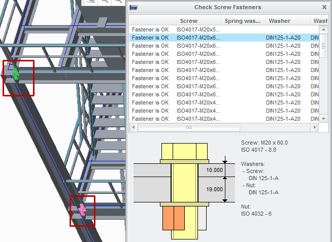

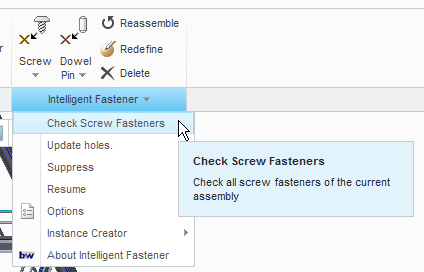

  • ... it's impossible to locate it in the model tree. ...
    In IFX you can use the Check Screw Fasteners command to open a dialog with a list of all assembled screws/bolts.
    There you can check your fasteners. If you click in the list, the corresponding fastener is highlighted in the graphic window.
