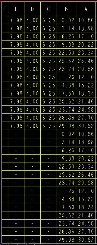

I have a drawing with a couple of holes done as a cut and only available
on half of the documented instances in the drawing table, so I thought I
would create a feature parameter with the expectation when the value was
shown in the drawing table for the number of holes it will switch from 2
to a dash, but nothing is showing. Does anyone know what I am screwing
up?

Brian....some thoughts that may help? Is the feature param in the Table or did you create a model level param with a relation driving the value from the feature param? Is your draw table cell looking for &fam.inst.param.value for the instance? Is the table cell filtered with the rule &fam.inst.param.name==your_model_param?
The PTC KB article notedbelow may also help http://www.ptc.com/cs/cs_26/howto/dwt_no2d/dwt_no2d.htm
Suggested Technique for Creating a Table of a Family Table Part Without Using a 2D Repeat Region
Regards, Jim

See in line answers to questions about what I am doing with the table.
Brian S. Lynn
Technical Coordinator, Product Engineering
brianlynn1-VisitorAuthor
July 9, 2010
JPEG of the drawing table.
I just verified that the parameter name and the filter match, just so you
know.
Brian S. Lynn
