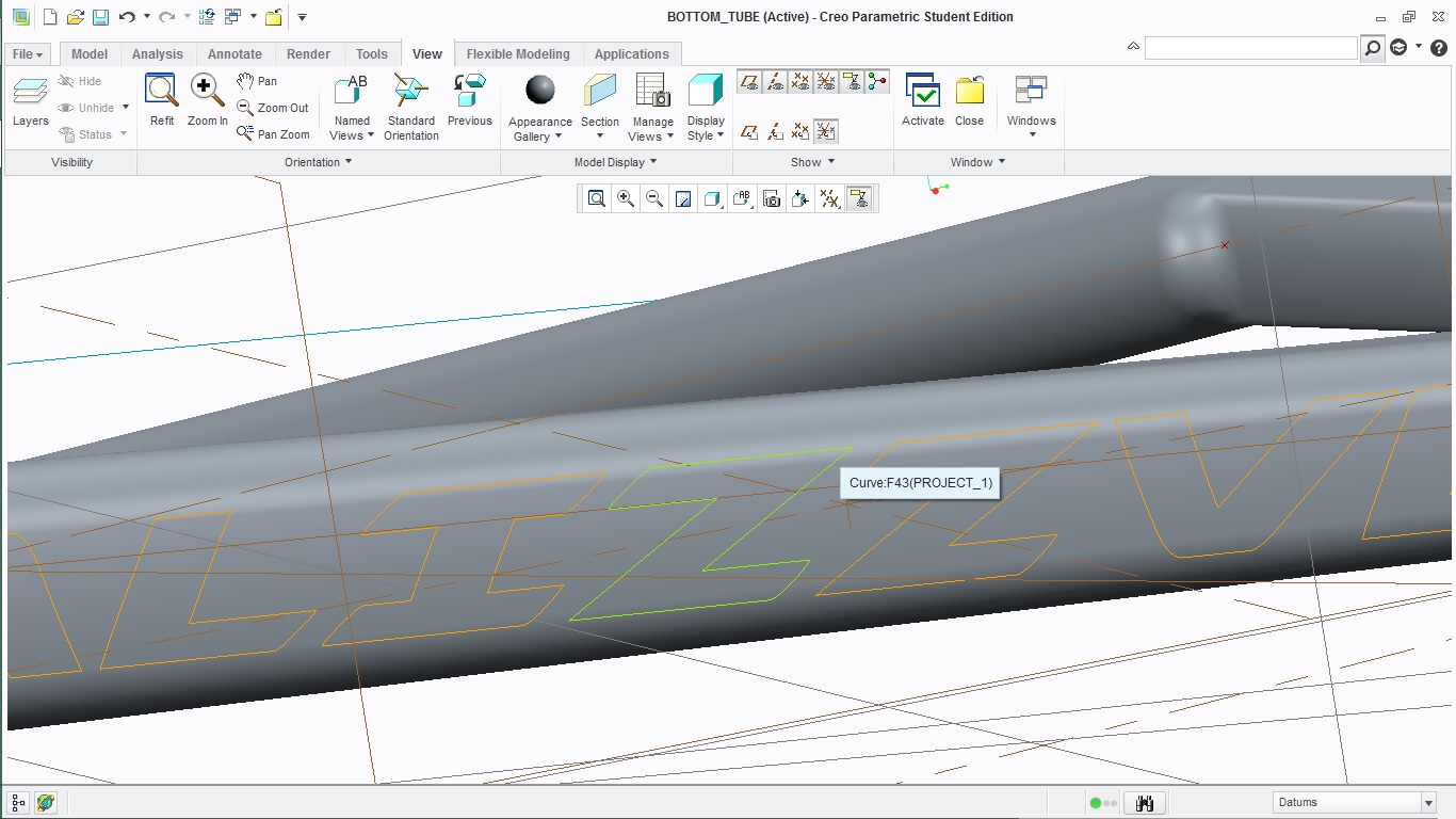

Martin,
Thanks, but the problem is that the text is projected in a curve surface, then I can't extrude it. I tried converting it in a curve feature, but is the same thing.Untitled.jpg
Feb 24, 2015 2:06 PM UTC
Ruben,
I guess you can
  1. make a surface ofset from the target surface
  2. make extruded surface from text section which intersect the surface created in step 1.
  3. merge surfaces created in step 1. and step 2. and select the appropriate part of geometry to get surface representing the text
  4. assign color to surface created in step 3.
Martin Hanak

JLG,
I used a cosmetic sketch, and it works. But! as you can see the surface is not planar, when I tried to project the sketch over the curve surface, the XHatching fails, only the boundary lines are projected.
Thanks anyway.

Feb 24, 2015 4:39 PM UTC
If it's just for 3D rendering, offset the quilt you'll project onto by .002 or so. Change the surface color, then use the curve to trim. If it's for a dwg, then you'll have to make the curve has hatching, and then in the dwg, set the hatching so it looks solid. I would avoid using cosmetics (except for threads), they don't work as well as curves. I never use them. You can reference them or use them for anything else, and they show through the part, unlike curves.
Feb 25, 2015 1:53 PM UTC
Frank,
It's for 3D rendering. I tried your option and the curve doesn't project over the offset quilt, it projects incorrectly, so I can't trim it. On the other side, I tried to trim it using only one surface (this time the surface was projected correctly) and it works, but only for that surface, and even when it works, I have to repeat the same process 2 times for each letter (including the surface offset) all because Creo doesn't allow me trim the surface multiple chains. There are several curves and surfaces, so I couldn't fill the text.
Thanks anyway.
