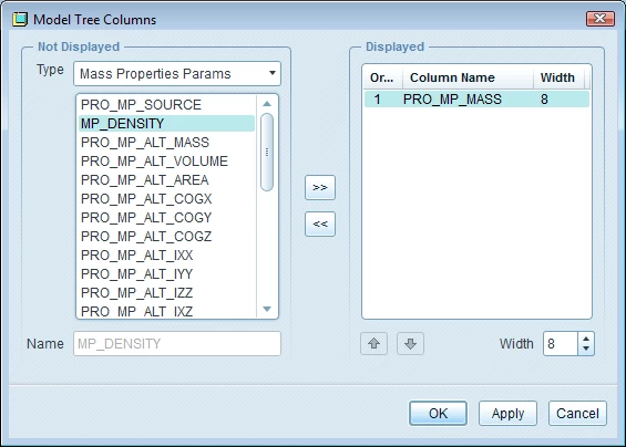

I have a medium-sized assmbly (about 80 different components) and I am trying to find its mass and CG. I assigned all the materials but I must have made a mistake in one or more parts because it's wildly overweight. I can figure out how to generate a list of the parts showing their mass individually - I'm sure whatever is wrong would jump right off the screen at that point.
I also tried adding a column to the repeat region on the assembly drawing that would show the mass, but the closest parameter I can find just shows the density and it's not really helpful. I'm sure I've assigned an in-lbm value to a kg-mm-sec part somewhere though.
Any thoughts?
TIA
January 3, 2014
Add the PRO_MP_MASS parameter to either the BOM or the assembly model tree. The "heavy" component should quickly show up.

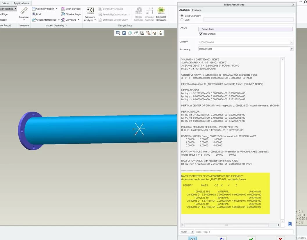

OR simply look at the bottom of the Mass Properties box.
It gives you filename, density, mass, CG (X,Y,Z). If you have sub-assemblies, it only shows the mass and density of the sub-assy, that's when the model tree columns come in really handy.
