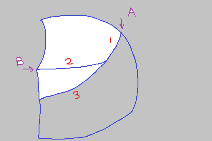

Ok now let's say you have the below set of boundary curves and surfaces (the grey being surface/quilt) and you want to fill in the two empty areas with two boundary blends. If you have a curve like B which "branches" off of A, is there a way to select only the portions 1,2, and 3 individually for use as boundaries?

Yes. After selecting curve A, right-click on the white square of the end that you want to shorten (or extend), as seen in your image it would be the right end, and select Trim At. Then select curve B as the trimming object and this will trim A where it intersects with B, thereby giving you the section you labeled as 3.
Also good, I like to place points on curves to use as Trim At objects.

It works so beautifully! How I ever survived without knowing this before, I have no idea. Thanks immensely.
