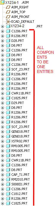

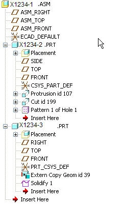

ProE creates a circuit card assembly using emp and emn files. The original
ProE CCA X1234-1 needs to be cleansed for Teamcenter such that it only have
two componens, the PCB and all sub-components combined into one. Our
company contract this job out. Unfortunately, I don't have direct
contractor contact and stumble on some of the CCA files that haven't been
cleansed yet. Does anyone here have an idea how this could be done? Any
help would be greatly appreciated.
Frank
