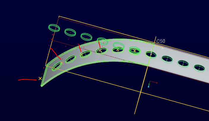

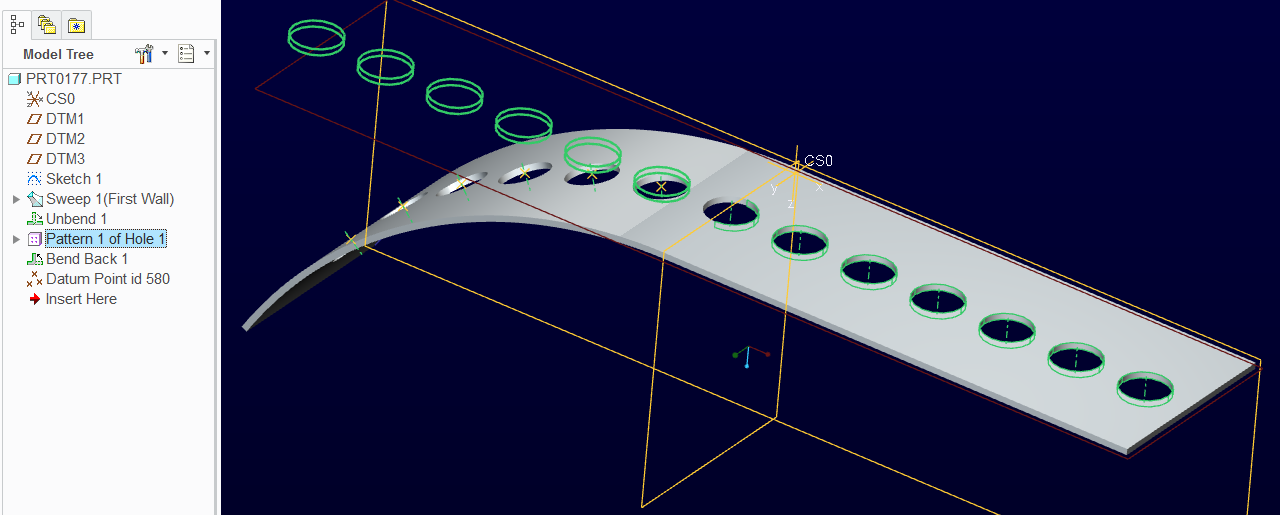

The picture shows the model tree and the bent item, with the hole axes marooned in free space.
I tried placing another set of axes, through a point and normal to the surface, before the bend feature, and got the same result, just with some additional marooned points.
I also tried doing the bend first, then an unbend before adding the holes and finally a bend-back. Still the same result.
Where are we going wrong?

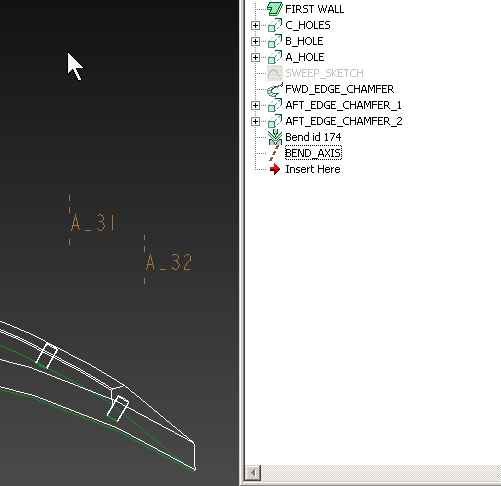

John, I've had axes do both things... stay on the flat position in some instances and others it would go with the metal. The axes should be created with the feature and maybe they are hiding with intelligent layers.
This is Creo 2.0. You can probably follow the structure. You also see that the axes moved with the bend-back.
However, opening this part today, the points I placed at the intersections of axis and surface moved off to a projected state from the flat until I edited the definision of the points. Bad form!
I guess I better report this one.
