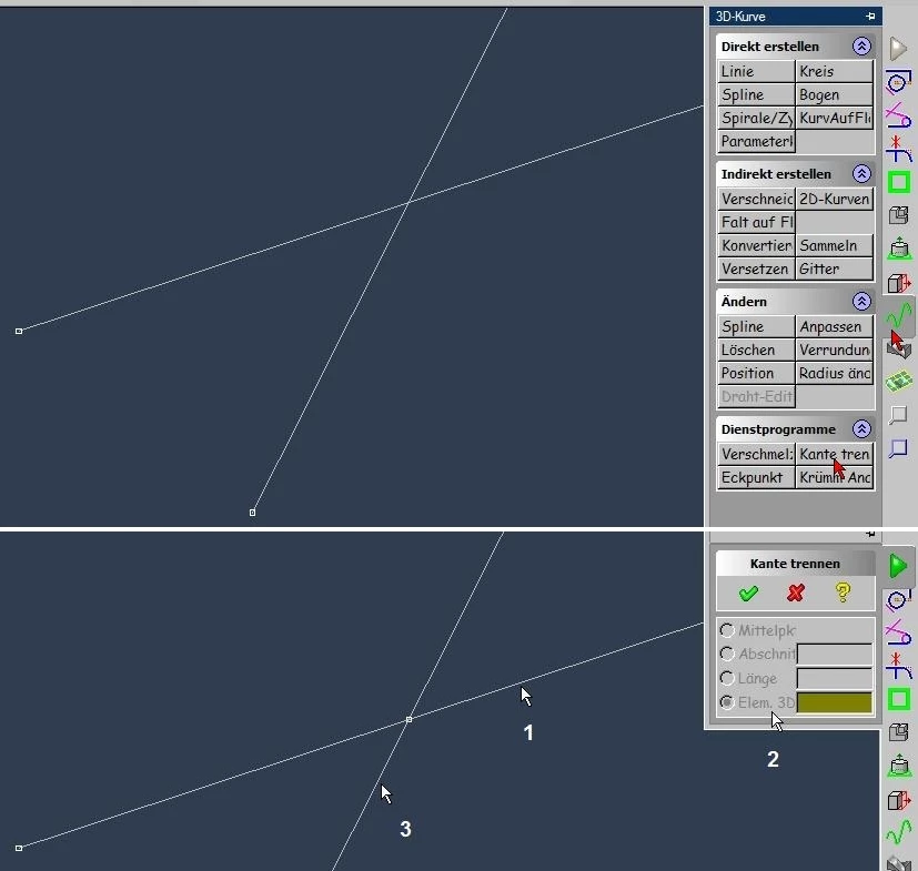

Hi Frank !
You have to cut one of the lines at the intersection point. Then you get a feature to catch.
I attached a picture, but unfortunately from the german version.
In the 3D-lines function you find it nearly at the bottom.
First click the line, then click the button "element-3d" and then click the crossing line at any point.
Should work at a sphere surface too.
