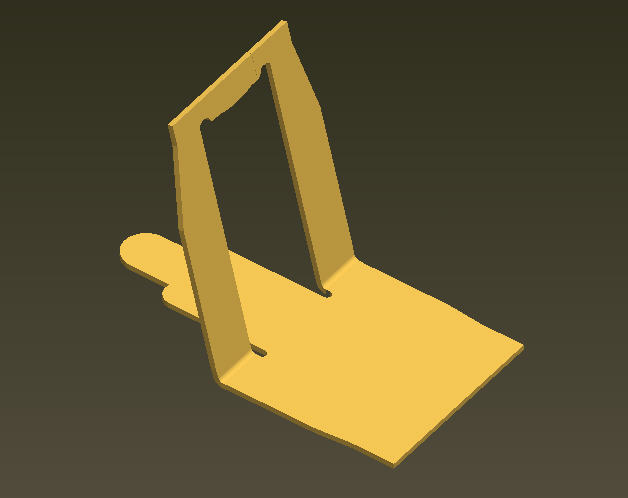

What is the method to create sheet metal bend that has a flat area as shown, since bend line in sketch must be one entity?
This is a simplified version, so I can't use forms or punches.

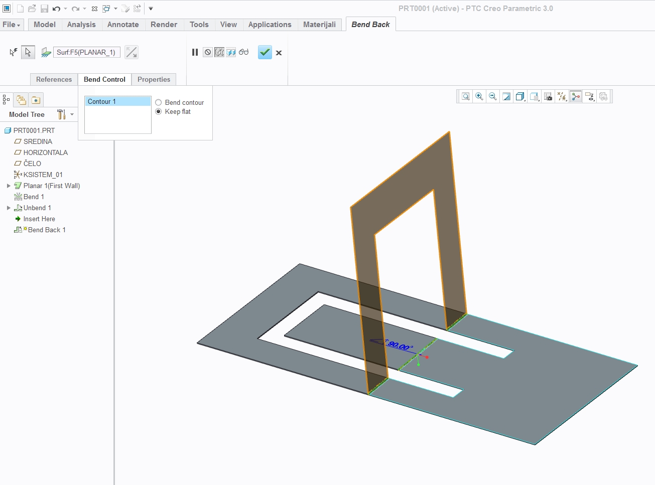

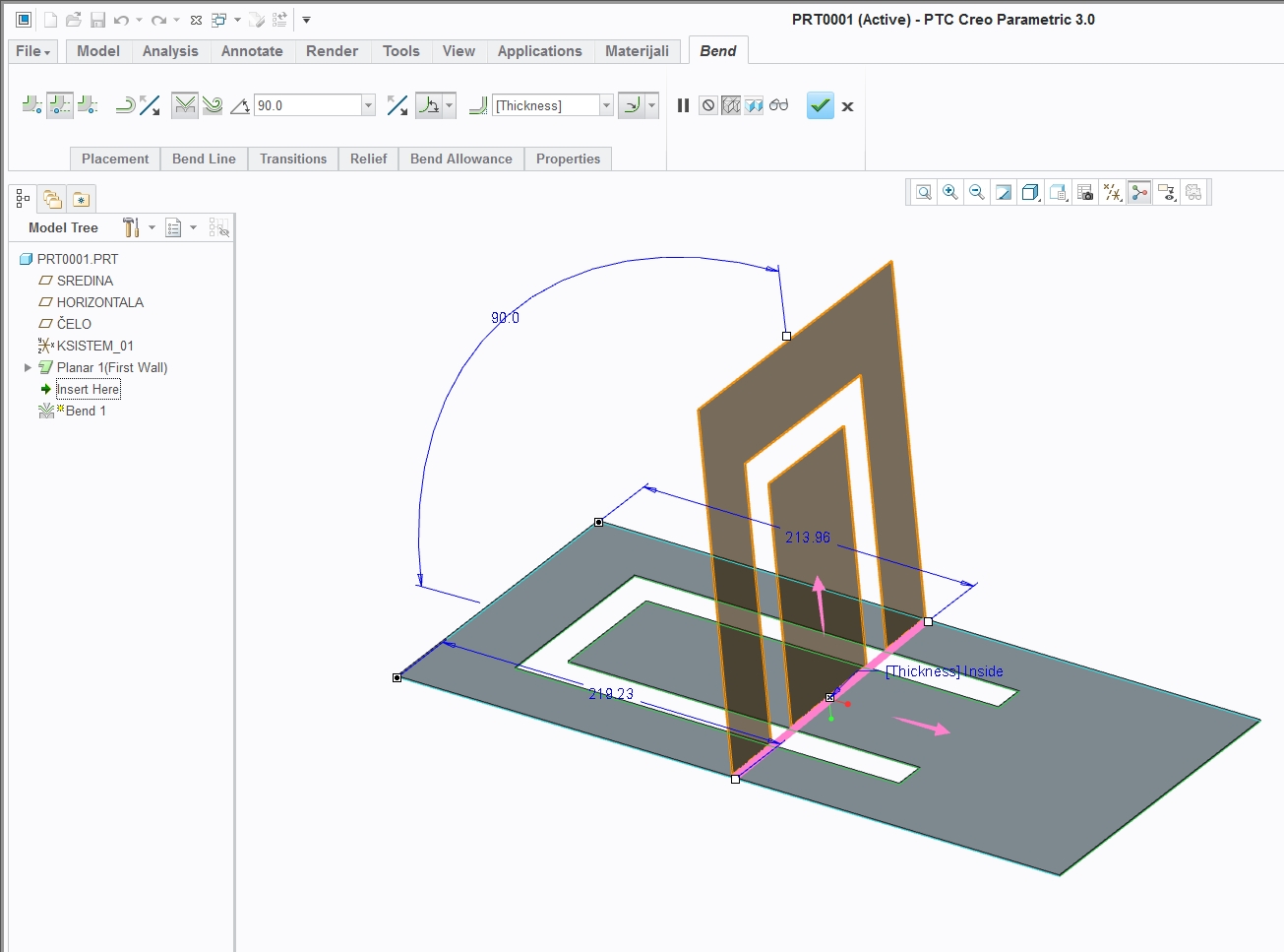

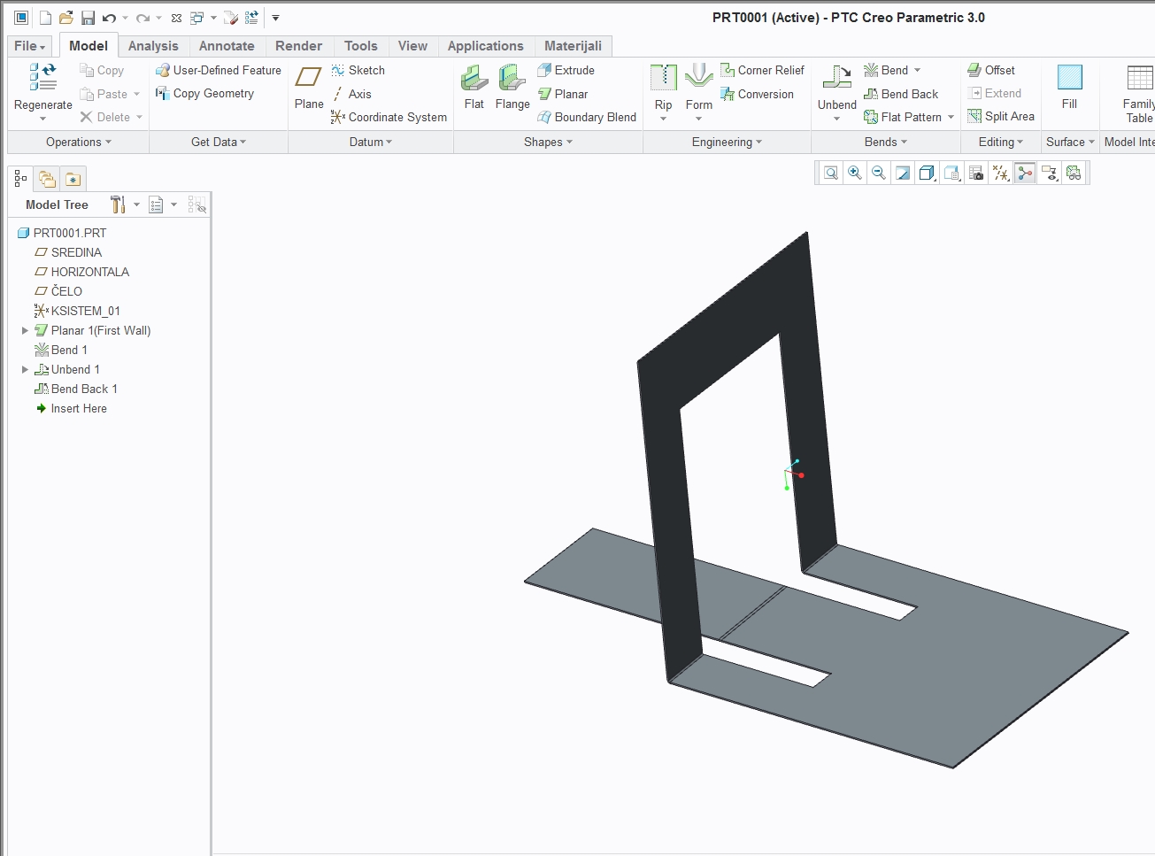

Hi Curt,
You can bend all with middle segment in sheetmetall,unbend and then bend back using "Bend control" tab selecting "keep flat".
Cheers

Hi Curt,
Cheers
