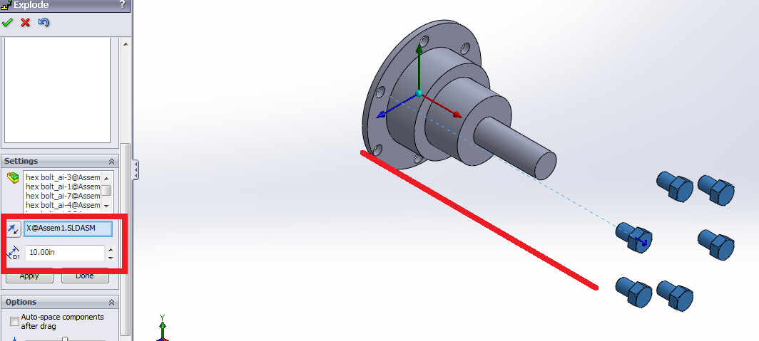

Thanks for reply.
Earlier I was used Solidworks software in that we can easily move parts or sub-assemblies by giving dimension in exploded view. But here in Pro-E I'm not getting it or I think the function is not availble in Pro-E.
Naveen Kumar Gongu.
April 10, 2014
Hai,
I am placing here a small example of parts moving with 10" space. please take a look into picture,

April 10, 2014
I think motion increment is for dragging increments. I was able to set the increment to 1 and then drag out to 10" (CREO 2) but if you are looking for something more precise I don't know how to get it.
Since the explode views are typically used for a nice (or aesthetically pleasing) position in a drawing, I don't think they were ever intended for precise locations.
