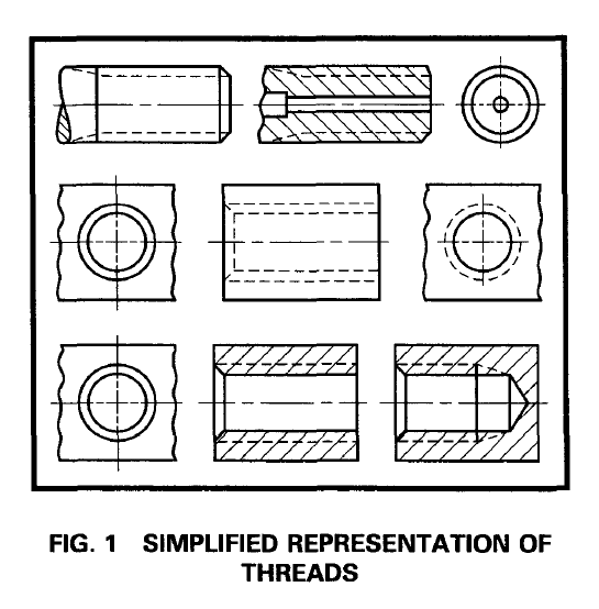

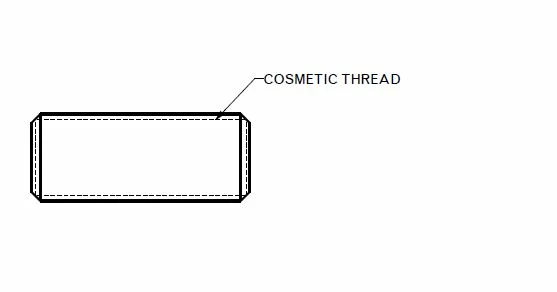

In Creo 3.0 if we give cosmetic thread in 3D model...that is shown as hidden line in 2D drawing... Can anyone suggest me is that correct ? if so can u please share the document on the same.

In BS8888 a female thread would be hidden detail but a male should be a solid line but thinner than your main drawing lines. You may need to look at the config options and your .dtl

If you go into "Tools" then "Options" you ca set your "config.pro" options.
For a full list of options google "creo config options" this should find a PDF "PTC Creo3.0 Configuration Options"
Here is a link to the list of .dtl settings http://www.beyondmech.com/pro-e/cad-topic-31.html

May 27, 2016
ASME Y14.6
