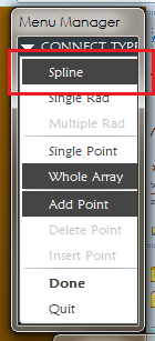

Is there a way to set the Pro/Pipe default option to spline instead of single rad?
Thanks!
    June 7, 2012
    I've read somewhere that you can change menu manager's defaults in menu_def.pro file which is located in text folder of Pro/E instalation, but I've never really figured out how to do that.

    Hi Kris...
    Don't bother with the menu_def.pro. I already tried making the file and getting it to work- and it doesn't. You cannot reset the default for a menu that already has one... and this Connect Type menu already has one (Single Rad). You also can't set default for a compound menu... and Connect Type is compound. Therefore, you cannot override it due to these restrictions.
    Waaaaay back in ancient history you could find text files for each menu set and tweak them. I don't think this was ever endorsed or mentioned as a formal possibility. But those days are long gone. I think you'd just stuck clicking the button... or else making a mapkey to drop you into Pipe->Spline without having to pick from the menu.

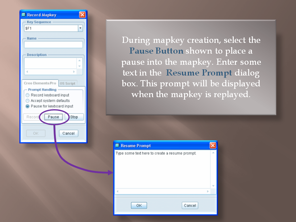

    June 22, 2012
    How about just making a wee Map key that also pauses for appropriate input (multiple radius, outside diam etc) but defaults to spline?
    Then make a pretty icon that drives the mapkey?
    KrisR1-VisitorAuthor
    June 22, 2012
    That is an option.....I've made simple maypkeys before, just would have to learn how to incorporate the pauses.
    June 22, 2012
    Hi Kris...
    Incorporating the pauses is very simple. Just hit the Pause button during the mapkey creation. See below...
    Take care and have a good weekend!
