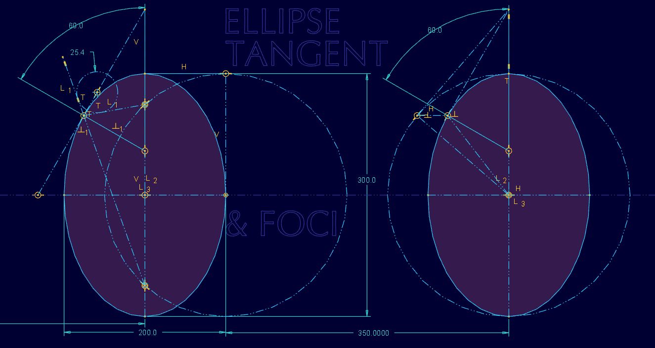

In the event you need some control over your ellipses, please refer to the diagram for some guidance.
This document depicts an easy way to locate the ellipse foci and two methods to obtain tangents to the ellipse so you can base further geometry on them.
The rightmost image is fairly obvious.  The leftmost image uses the foci and the midpoint to establish the tangent, resulting in a reliable the perpendicular vector as well.
I needed the perpendicular for machining on an elliptical surface.  I learned quickly just how unfriendly these exotic curves really are in Creo.
