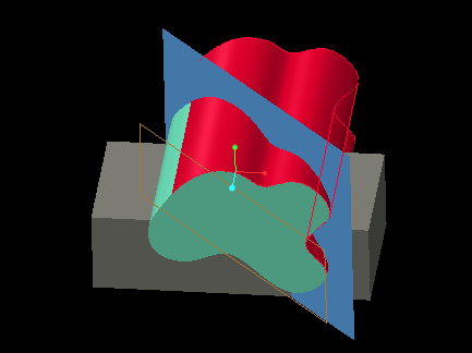

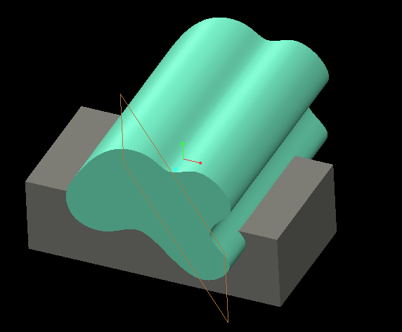

Pic of two parts assembled together. Yes, this is a crude view, but it's only to get the instructions done.
Part1 is the greenish part. Part2 is the greyish part. You can see the datum plane (from Part2).
For this exercise we'll be putting an curve around Part1 where the Datum Plane from Part2 intersects.

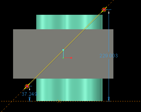

Create an extrude, but make sure to switch it to Extrude as Surface. (I picked the bottom of Part2 as the sketching plane.)
Pick the Datum of Part2 as a sketcher reference and sketch a single line. The ends of this line should fall outside Part1.
Make the depth go through Part1.

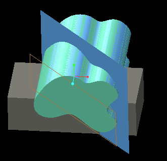

Make a copy of the geometry from Part1 you want to intersect. To do this, change your selection filter to Geometry.
Select the geometry surface you want to intersect. You can select multiples using the Ctrl key.
Copy/Paste using Ctrl-C/Ctrl-P. Note the stippled surface denoting a surface at the same location as that portion of Part1.
Select the Copy and the Extrude created above.

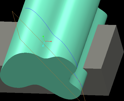

Pick Intersect from the Modifiers fly-out menu.
Hide the Extrude and the Copy. You now have an intersect curve.

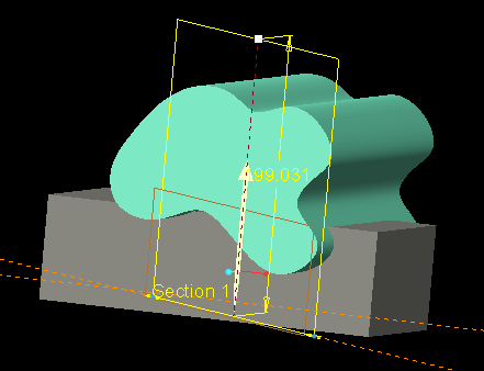

An option that might work would be to create a cross section with that datum plane and then create a Datum Curve from Cross Section.

thanks your suggestion it's interesting too and maybe faster, remains just an aesthetic problem with the entire curve from cross section view showing up once you create the curve from the section...if only it would be possible to hide all the chains you don't want to show and keeping only the portion you need....
