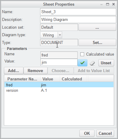

The function has also been extended to support any user defined parameter.
For example I have created a user defined parameter "fred".
I added parameter fred to my sheet properties

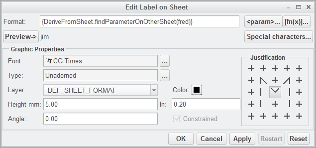

On my design sheet I added a sheet label using format {DeriveFromSheet.findParameterOnOtherSheet(fred)}

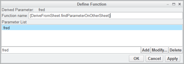

To have the parameter work with artifacts I modified parameter fred to have a derived function using the Function name of {DeriveFromSheet.findParameterOnOtherSheet} and added fred to the Parameter List.

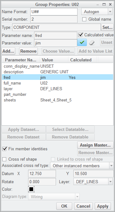

I then added parameter fred to the artifact properties and check on Calculated Value
