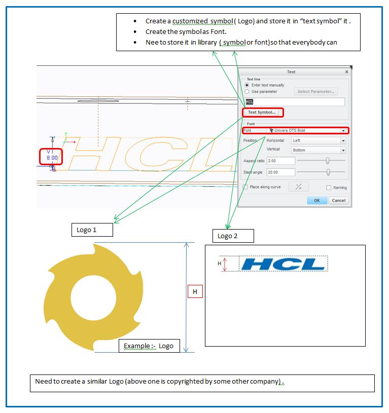

Dear Experts,
I just need to create a parametric company logo on Creo part interface and the logo symbol should have only one controlling dimension even though it has extricating geometry.
Scope:-
· 1. To Create a scalable Logos on Creo and need to emboss logo on part model and add material.
· 2. Logo will be controlled by a single dimension.( Example: Logo size should be controlled by height, if H equals height and the width is 5 times longer than the height then the width would be 5*H.)
· 3. Create dimensions that are all a function of the vertical length of the left most line.
Can we create on text form and use as library file. (Example: with “.ndx” is the file extension)
Could you please guide me on this?
Thanks in advance!

February 12, 2015
Dear Sir,
My customer requirement is to create the Logo as font format and it can be use in sketch mode to add or remove material from the CAD model.
I need to use below mentioned sketch interface to call the Logo ( as font, that save in Library) .
Example:-
Convert,
Logo JPG --> as "New Font" creation and call in Creo modeling phase( sketch mode)
Logo JPG --> Symbol ( that can be protrude in modeling phase) (sketch mode)
Hari

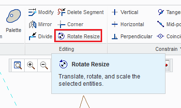

Hi folks - every body is right (create logo by points, use custom font, relations, etc.). I use all this technics for my model of PTC logo.
Base question is: how to scale created logo?
My answer:
  • Create 2D sketch or 3D model of logo (custom predefined dimension)
  • If you need reuse the sketch with different scale - it is not problem. Save the section to your library and then you can easy scale sketch in Sketch mode

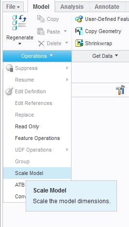

  • If you need to scale 3D model >> make a copy of original model >> OPEN model >> and use function SCALE MODEL (set custom scale factor and ... )
