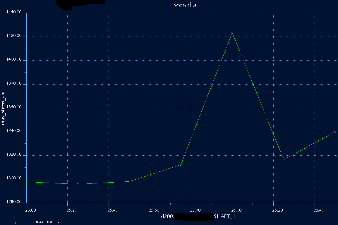

I've just run a Mechanica sensitivity study (linear static, using Single Pass Adaptive, remesh and repeat P-loop each iteration) and got the following result:
(If this isn't legible, the lower end of the curve shows just under 1300 MPa at a dimension value of 25, increasing to 1340 at 26.5 but with a spike of 1420 at 26.0.)
I've used mesh controls to apply a pretty fine mesh, and geometrically there's no reason for any odd results at that particular point (I'm varying the bore of a shaft with OD 42, and max stress is on a chamfered radial Ø3 hole through this portion of the shaft).
More strangely, I then set the dimension to 26 and ran a single static analysis - and found a max_stress_vm of 1321 MPa, which fits the curve pretty much perfectly and disagrees with that high data point.
This spike is a variation of 7-9% on the 'basic' stress which seems like a very large error margin - what gives? I've tried Multi Pass Adaptive in the past, but I've found that without mesh controls it doesn't necessarily converge well, so I generally just use SPA and use my judgement to add mesh controls where needed. As you can see, six of my seven data points do follow a smooth curve using this technique.
