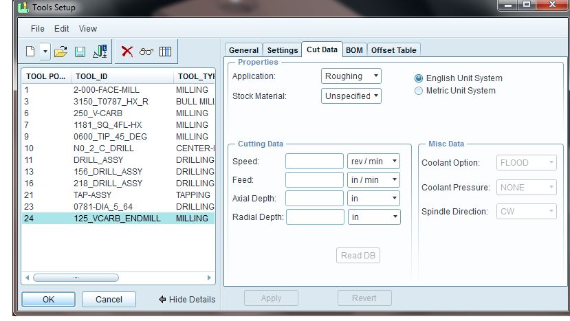

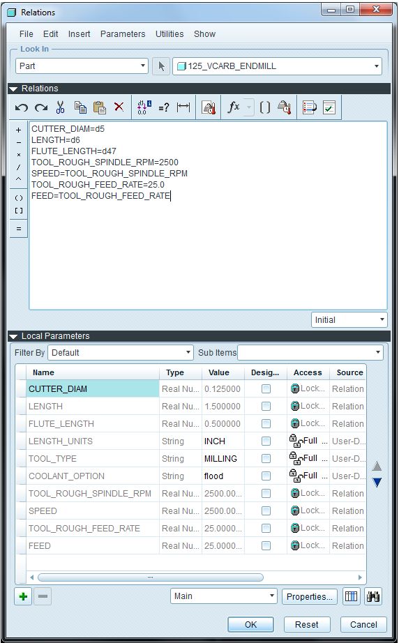

Hey guys I have a question about solid tool models, is there a way to include my spindle speed, feed rates, step downs, and step overs in my relations? I have been trying to get them to work but, when i use them in a nc sequence my rpm, feed rate, ect do not come with my solid tool model. Anyone have any info on this?

Check if this option is set to yes:
mfg_param_auto_copy_from_tool

No go on the mfg_param_auto_copy_from_tool, It seems like Pro doesn't recognize the feed and speed relations, yet it will recognize the coolant options.
May 16, 2013
I confirm, I have almost all my tools as solid tools, and parameters never copy. I have to do it from the menu, edit>parameter>copy from tool.
This makes loose really a lot of time !!

Set <mfg_param_auto_copy_from_tool> option to ALL
May 17, 2013
It makes no difference. I have this option set this way and it doesn't copy them to the sequence !

It works for me (but coolant option). Do you select stock material?
Our tool files contain data for several stock materials. I am not sure if is necessary.
Create this file:
mfg_wp_material_list.xml
with stock materials.
