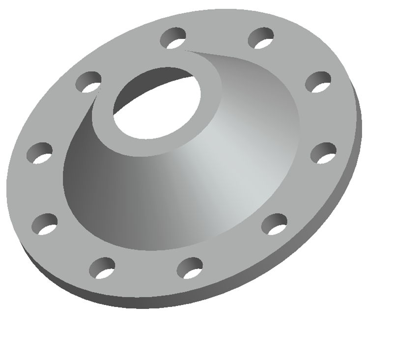

Need help with this revolve
I need help setting up the dimensions and format to look like picture number 1. Then when revolved looks like picture number 2. I know how to the pattern holes already.

Start by choosing the revolve icon.
Pick the plane you want to sketch on (Front).
Pick the plane you want as a second reference - typically the right (as shown on your sketch).
Make a centerline coincident with the right axis.
Sketch you shape (don't worry about sizes).
Lock the dimension and change one of them to get close to the dimension listed.
Adjust the rest of the dimension.
Select OK (probably 2x - to get out the sketch and to get out of the revolve.)
Unless you have to have the "dimensions" as shown, typically with revolves, you would (for the 50 dimension) click on the vertex, hold the control key down - click on the centerline made, continue holding the control key, re-click on the vertex, and then click above those points to place a 100 dimension that will straddle the centerline. Do this similarly with the 125 (to get a 250). Then the revole "knows" what your revolving about.
Hope this helps. (do I get the grade too?)

In WF5/creo, and perhaps also newer versions, you have to make sure the centerline you want is picked and specified in the right-click menu as the axis of revolution. This is a complete pain. This is a step backwards. It used to be that you knew that the first centerline you created was automatically picked as the axis, but you could then change it to be whatever axis you wanted, unlike the versions older than that where the first axis was the only choice unless you deleted the others. I forget to do this ALL the time now in the "enhancement!" that is creo, and it really pi$$es me off. This might be your issue.
