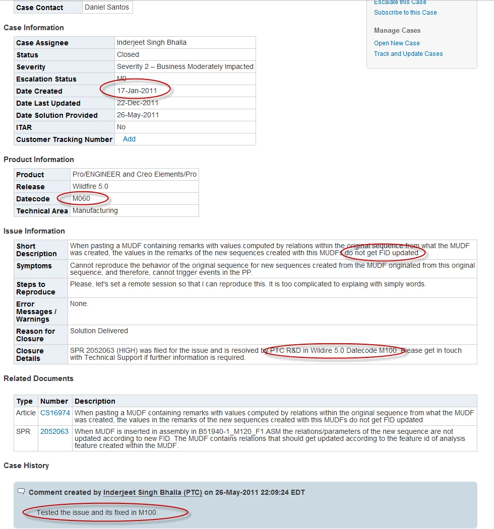

I am having an issue placing a UDMF in an existing manufacturing model. When I place the UDMF i am selecting a certain instance from the family tablethat does not place some sequences in the model. The issue is, I have the relations in the program and all of the relations are copied over to the current models relations. If the sequence is not placed in the model the feature ID number is not re-sequenced and interferes with a current sequence that is using the same feature ID number. Is there a solution for this?

I spotted this bug in WF5.0 M90 and it was fixed in M100 as far as I know...
