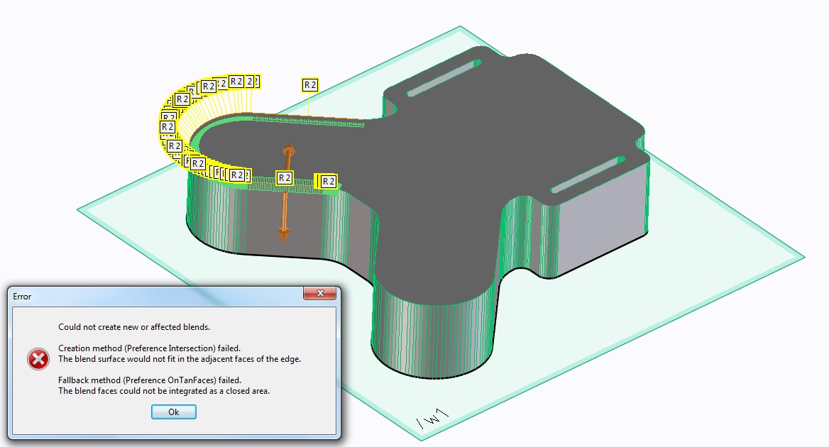

Hi, new to Creo, trying out creo elements direct express.
Whenever I try to apply a blend to the above edge I get this error:
"Could not create new or effected blends
Creation method (preference intersection) failed
The blend surface would not fit in the adjacent faces of the edge
Fallback method (preference ontanfaces failed)
The blend could not be integrated as a closed area"
any suggestions for a solution? Thanks

Welcome to the forum, Crans.
What is the source of the original model? It looks like an imported facet model.
November 5, 2014
The model you see was created by first importing a .step file into creo (a circuit board model exported from Diptrace) then a workplane was created on the PCB surface and the outline of the PCB projected onto the workplane, from there the outline of the surface was pulled to create a solid part. Then i tried to apply the blend tool to the edge and had problems. I am trying to create a 3d model of an enclosure for a PCB, which i will then 3d print. Thanks
the original PCB model file is eldis.step which i have posted with this message
November 5, 2014
Yes, I can see that. This is a very poor import file. Even though it is STEP, it is actually a very crude DXF using polylines that is masquerading as a STEP. Even DXF should have created arcs but this one didn't. The only actual arcs in the file are the 4 small holes.
Can you get a more native version of the circuit board file? I'll see if I can recreate it with a little more intelligence.
