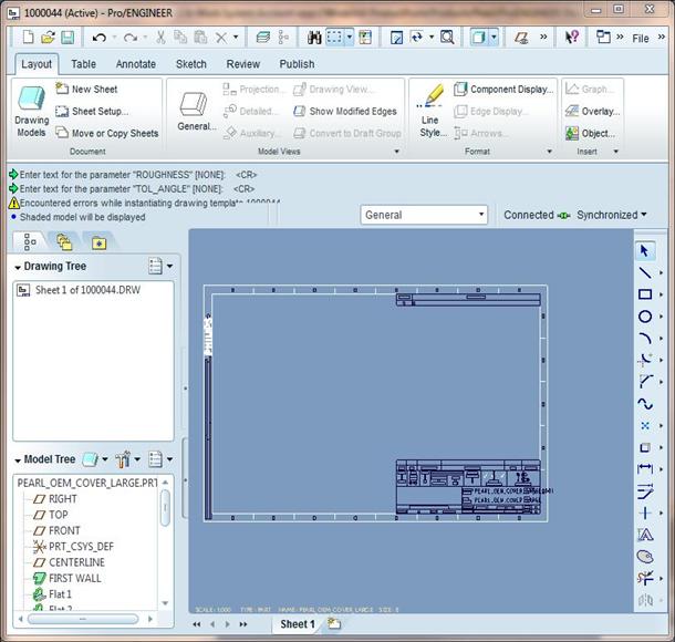

Update the drawing capabilities to be equal to what they are in Sketcher mode. Sometimes there is a need to create just 2D drawings for a quick display, plant layouts, flat flexible circuits, etc.
Currently in Drawing mode you are extremely limited on what you can do, and what you can do is very hard to figure out and remember.
Here is a pieced together screenshot of what I would like to see:

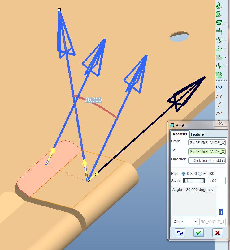

It would be nice if dimensioning was all done in one dashboard control. After clicking the measure icon a dashboard came up and I could select which type of measurement I wanted, or Pro/E would just know from the selections I make.
I also have a really hard time with the angle measurement. Usually I want to know the angle between two surfaces. So, I pick those surfaces. Pro/E then gives me the angle that I would not have even thought of wanting.
Here is a quick screenshot example:

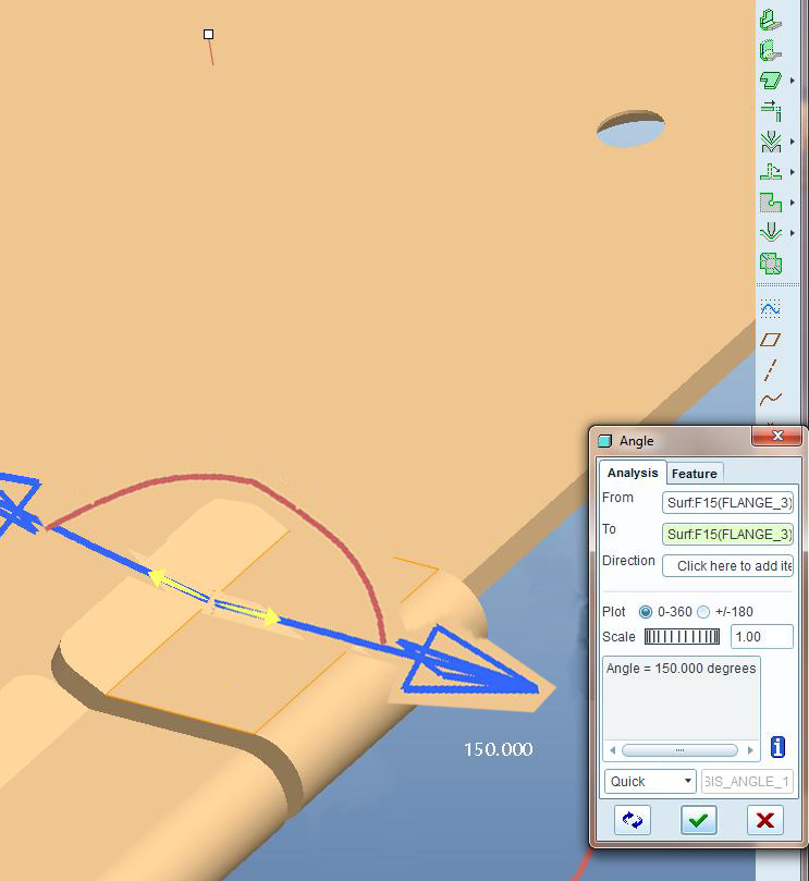

I then have to click on arrows till I get the angle to switch around to display what I hope is right. You never can get it to give you the actual angle between faces.
Here I found the correct angle, but why is it shifted 90 degrees?
This is an easy angle to calculate, but it shows the point.
September 11, 2010

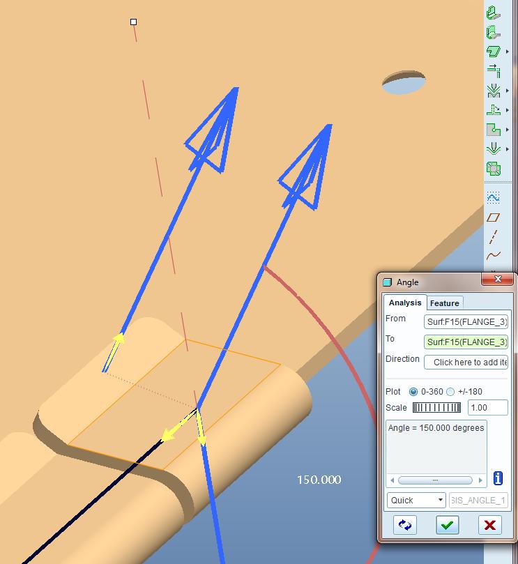

It measures the angle between the normal vectors of the surfaces. By default ProE uses the outward pointing normal for solid surfaces. Two of the arrows control the direction of the normals the other controls how the angle is measured according to the right hand rule. From your measurement you picked the horizontal surface first then the angled. Having the normal for the horizontal surface pointed up and moving the angled surface normal so they have the same origin the angle is measured clockwise (+) by right hand rule. If you flip the yellow arrow normal to both surface normals you measure counterclockwise and get -330. If you flip the horizontal surface normal direction you now measure counter clockwise (+) and get 150. If you flip the yellow arrow normal to both surface normals you measure clockwise and get -210.
The easiest way to see why the angle you initially get is wrong is to look at how the normals get oriented with a protractor in mind. So think of a protractor measureing the angle with 0 along the horizontal surface and 150 on the angled surface. Extend arrows in the 0 and 150 directions. Now rotate them 90 degrees counter clockwise to see how they should be oriented to get the correct measurement. Notice in your picture, if you left the horizontal normal pointing up, the angled normal would point in the wrong direction because from the protractor example the normal is rotated 90 degrees clockwise. So on a protractor with the arrows moved to the origin you have the horizontal normal arrow lined up with 90 and the angled normal arrow lined up with 60 (angle between them is 30). When you flip the direction of one of the surface normals you then get the correct angle measurement.
pwyndham1-VisitorAuthor
September 12, 2010
That is a great explanation. But I still think it would be much easier to figure out if it just gave you arrows like my hacked up example below. I shouldn't have to hold my right hand up to the monitor and hum and ha about it. I don't use a protractor I use Pro/E. I never learned how to draw 3D. I expect Pro/E to do that for me. Then tell me what I want to know.

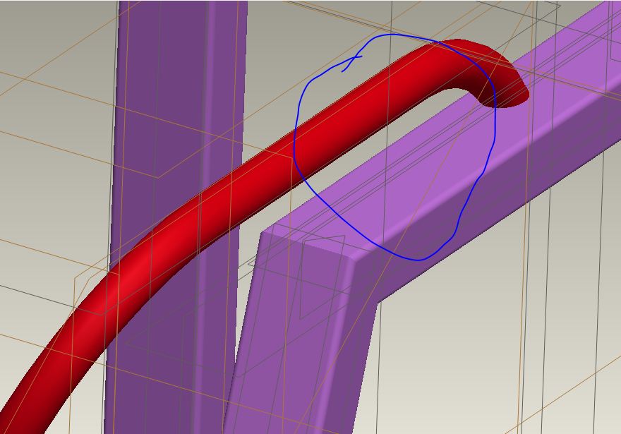

Just thought of this one while trying to add a new part to an assembly.
I think it would be nice to be able to only show the datum of of the part in the assembly that you are working on. Then, also turn on daums of other specific parts or maybe the top assembly.
Sometimes it gets so hard to see what datum you are trying to click.
For example: I want to build a new part that fits between the purple and red tubes. I want to build it using the internal part datums.
I know that picture is too small to show everything. But it does show lots of datums.
September 28, 2010
Yes, it would be great to have more options to show or hide datums during you are adding a new part to the assembly.
