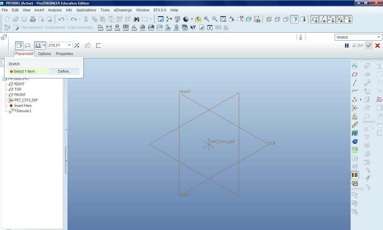

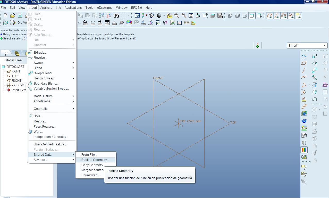

October 15, 2010
The assembly files only works if them parts are in the same file or by a search path, sometimes i needd to work with one assembly or parts for a lot of projects search path is to slow for my PC
the placement tab sometimes only for one reference. i think that could be place on the dashboard.
copy and publish geometry is very usefull, deserves a place faster, in addition to the icon has already. I have some icons to fast acces but the geometry is placed as a text.

October 15, 2010
I think that would be really problematic to have the part locations stored in the part file or somewhere Pro/E could find them. Then, if Pro/E had to search a file structure everytime you opened an assembly, that could be really slow.
What your asking about seems to be a PDM (Product Data Management) System. PTC has several options for this. In my oppinion the best option is ProductPoint, especially if you are a small company that is used to server drive use.
I agree about the sketch placement drop down. That should definately be directly on the dash board without the added clicks to get to select the datum/surface you want to sketch on.

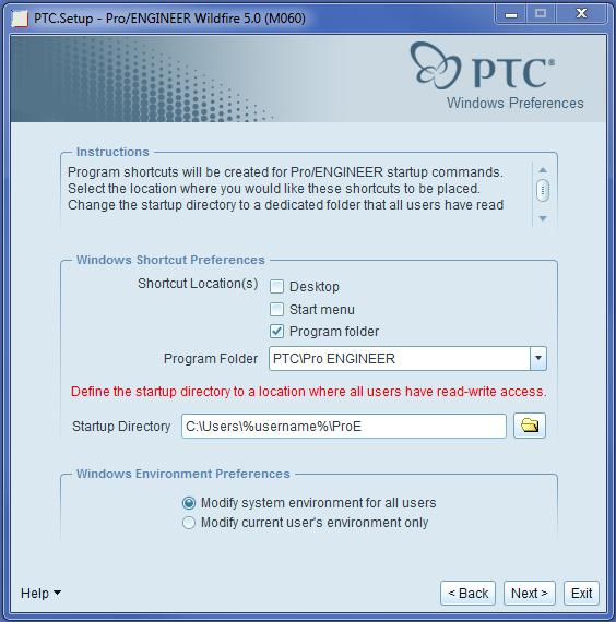

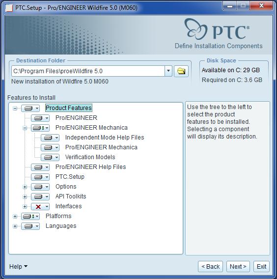

October 25, 2010
Since Pro/E sometimes does not like having spaces in names and directories. I wish that the default loadpoint did not have them. I also wish that it did not have the period in the path either.
For Toolkit I know PTC has told me that I need to install Pro/E in a directory without spaces.
Here is the default install screen:
Could be something like C:\PTC\WF5 or, maybe a better idea. Get rid of the whole issue around having spaces in the filename.
It would also be nice if the default Startup Directory was not C:\Users\username\Documents. That creates a lot of stuff to be dumped in the documents folder. Which in turn clutters an already, usually, cluttered area.
It would be nice if it defaulted to: c:\Users\%username%\ProE. Then, it would change according to who was logged in and it would go to a Pro/E specific location.
Then, include the option to install the ProductPoint client manager. Forgot to grab the screenshot, before I hit next.
Just my thoughts.
