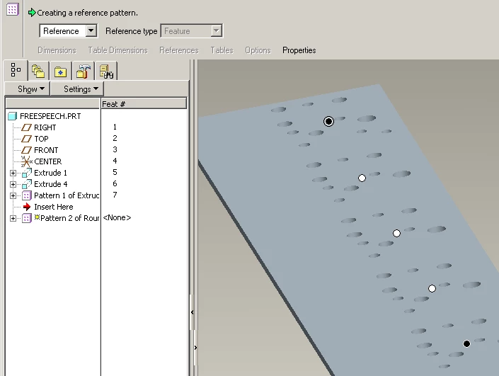

Another question to which I think I know the answer, but here goes:
In the case of a reference pattern, is it possible to selectively disable
individual pattern members? Like the little white dots in all the other
pattern types.
I create my reference features in my skeleton, use them to populate my
assembly with components, then things change, so I want to replace a couple
of the components with a different component. As far as I can figure out,
the only way is to change the pattern in the skeleton into two separate
patterns, each positioning a different component.
However, I hope you know different...
WF2, M220
February 1, 2010
We have white dots on our reference patterns. [WF4]
(It is a smart option. Thank you PTC.)
All the best,
Jered

I have the answer for the reference pattern issue:
It seems that Proe can't distinguish which pattern to reference if you
have more than one pattern in the same places, so you have to make
certain your reference pattern references exactly the same pattern or
all instances will end up on top of each other. The responses I got
follow:
The problem with reference patterns is that ProE has difficulty with the
reference pattern if the feature or component you wish to reference
pattern has references to multiple other patterns.
ProE expects just one patterned reference but if there are more ProE
places all the instances of the reference pattern on top of each other.
For instance, you placed a component with insert in a patterned hole and
a mate to the top surface, but you oriented it to a datum plane which
also happens to be patterned.
If you then wish to reference pattern the component ProE does not know
which pattern to choose as a reference and consequently places all
instances on top of each other.
I've mentioned this to PTC on several occasions. We need control over
the references you wish to use as a reference pattern.
Ideally would be that we can just choose any pattern to use as a
reference instead of one of the references of the first feature or
component.
It's great that since WF4 we can also disable instances of reference
patterns, but the ability to choose or change the reference pattern to
follow, regardless of the references of the first feature or component,
is the one thing that would make it complete.
So send in those enhancements requests and probably one day we will see
such an option.
We do quite a few carousels in our instruments so it's important to do
it right to avoid problems. For example, a carousel may have 24
positions with bearings, gears, etc. The first feature might be a bore
for a bearing, the second feature for that location creates snap ring
grooves for the bearing. The snap ring groove feature only uses the bore
geometry such as axis, edges, as references. This will allow the pattern
to be created correctly. HTH.
