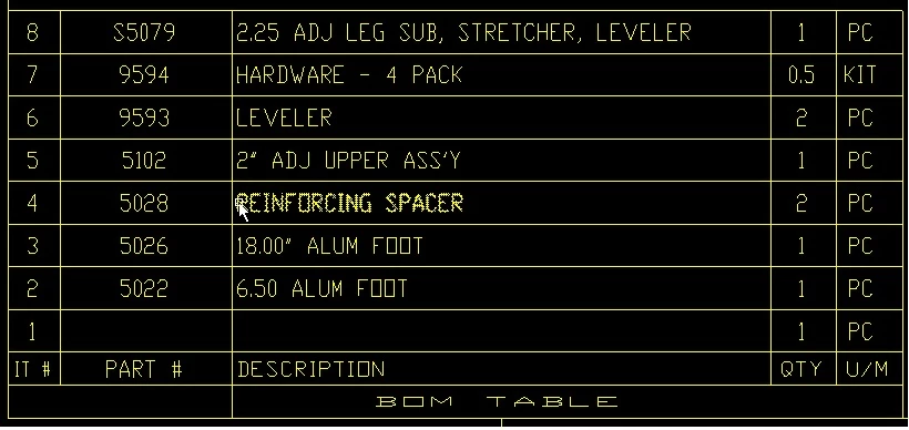

I have BOM's that are automatically generated within drawings. There are times when I'll open a drawing and one of the rows are blank. When I regenerate, the proper data fills in the lines, but why is this necessary when opening a save drawing?
Dale
Best answer by Dale_Rosema
While talking with a rep, after getting some new licenses installed, I was showing him this problem.
I noticed that the UM (unit of measure) had propagated, but not the description nor the PN (part number) parameters. (See WW_BOM_7)
I also noticed that UM was the only parameter filed in on the generic part even though the parameters had been filled in on the instances needed.
I quickly tested that discovery by adding values for the parameters of the generic. (See WW_BOM_8)
I saved the generic, the instance and regenerated the assembly and save it and then even closed out of Pro-E.

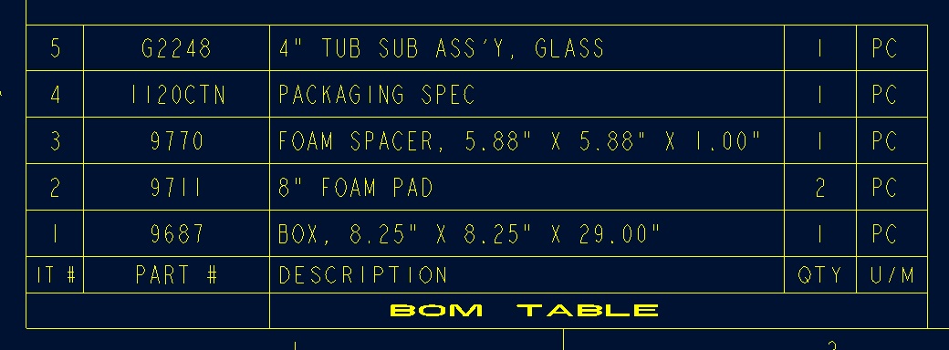

When I open the assembly, the values for the BOM table were in place and intact. (See WW_BOM_9).
The explanation that I received is that the null values in the generic are triggering the part to not regenerate the parameters of the instance into the BOM table. Once these values were no longer a null value, they will automatically propagate the table.

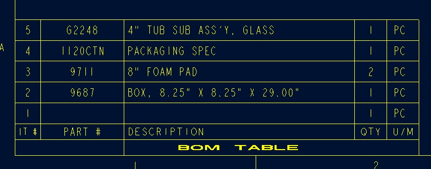

I opened up a part today and replaced one component, 1120 with 1120CTN. It. #1 which I have used before, dissappeared on the BOM (as far as description and part #) when I came back into the drawing.bom2.jpg
After regenerating, it shows back up as It. #2 - foam pad.

Take a look inside that 9770.prt file. THAT is the object which disappeared. The shifting of the item numbers occurs because Creo is sorting on the part number string. When 9770 isn't reporting, (as in your top image), it goes at the bottom because "nothing" comes first in the list. Later once 9770 DOES report, it belongs after 9711 and 9687 in the sorting order.
So I wouldn't worry about the reordering. I would still take a look inside the part that disappears, though. What parameters are there. What relations are in this part (Tools->Relation)? Are there any relations set for your BOM table that could be complication the matter (Repeat Region->Relations)?
And does this BOM update after you Update the sheet... or after your Regenerate the model. That's a big clue.
