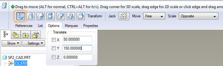

Dear all,
I'm busy with a scructure where I use a sceleton that comes from an 'imported wireframe/surface designfile.
I have cleaned up the designfile first, removing all I din't need but putting it on top of my assembly it results that the section of the designfile I use as sceleton is far away from the default coordinate system...
Sceleton parts seem to assemble automatically 'default'? So I can not move it in my assembly...
Replacing the base planes and coordinate system doesnt help, putting it default it is put on the 'old' coordinates...
Working in Creo 2 (not so familiar, came from wildfire 4 or 5) I tried to copy the imported feature and pase special to apply a move to it, but I cant copy...
So in short, how to put the default coordinate and a the coordinate of an 'imported' skeleton part together...
Thanks!
Didriek
February 28, 2013
You can use the 'Warp' feature with the 'Transform' option in order to move the geometry relative to the coordinate system.
So effectively you do not move the coordinate system but the result will be the same.

didriek1-VisitorAuthor
March 6, 2013
Just found a sollution by accident....
The first skeleton you assemble is 'by default', so when your default is not where you want in de imorted geometry you have an issue (this topic)
BUT, the second skeleton you assemble, Creo asks you constrains!
>> what I did is create an new, empty skeleton part A... set as first skeleton (default)
After, I put my 'imorted' skeletons in, by mate/align.... then I fixed them in that position so I can delete the skeleton A
= result, a nice assy whith the imported skeletons where I want them!
