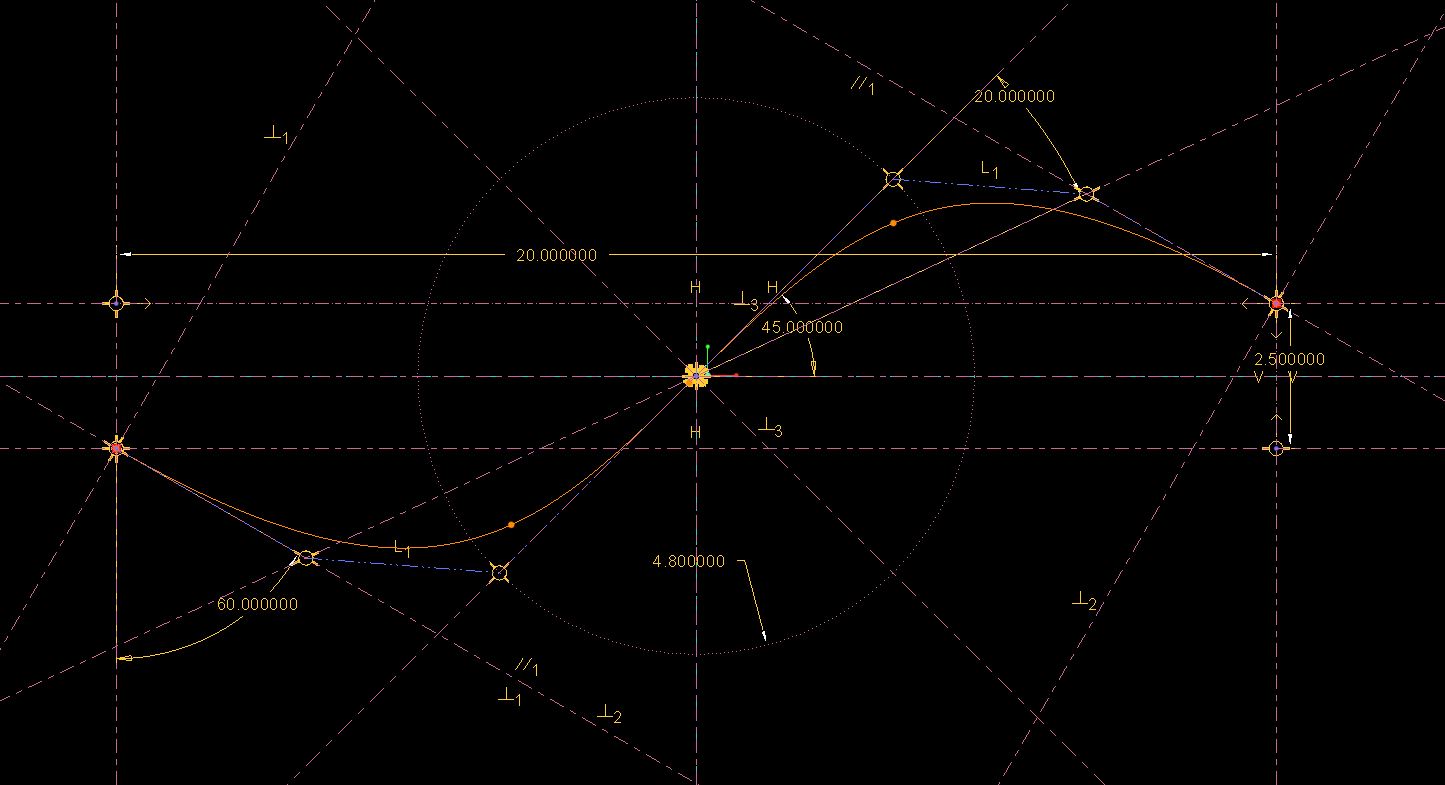

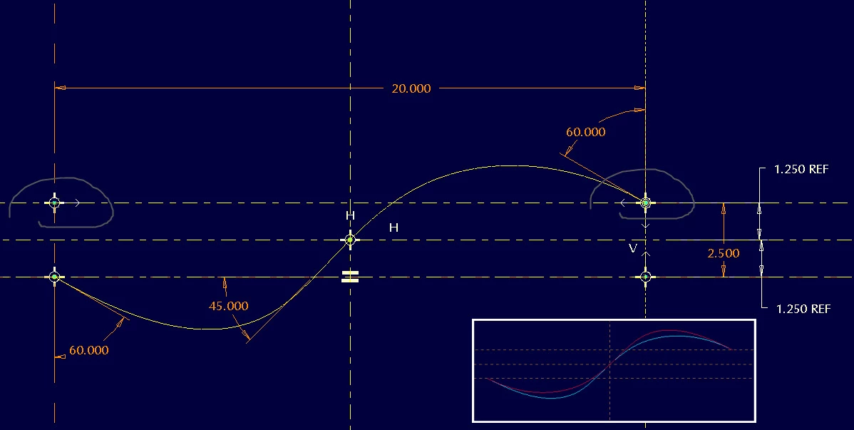

Can anyone explain to me what information I am leaving off this sketch?
The spline sketched below should be symmetrical, or more accurately, the ends should be as though they are rotated 180 degrees around the center, but they’re not. The little inset in the bottom right shows what it looks like when I mirror the sketch left/right then top/bottom. It should lie on top of the original but it doesn’t. The dimensions should make the thing symmetrical but don't.
January 28, 2014
For splines, there is position and angle but also the influence drag handle. You can mirror the position and make the angles the same, but making the influence drag handle symmetric is more difficult.
One way is to make half of your spline and then use copy > paste special on the sketch entity to create a dependant copy at 180 degrees. This has the advantage of leaving the spline drag handles "dragable" in your sketch.
Another way is to select your spline in the sketch, RMB and pick "modify" and on the spline dashboard pick the icon that shows the drag handle dimensioned. This requires you to fully dimension the spline, including the drag handles, however you can then make the drag handles equal and apply constraints like symmetric to the drag handle intersections.

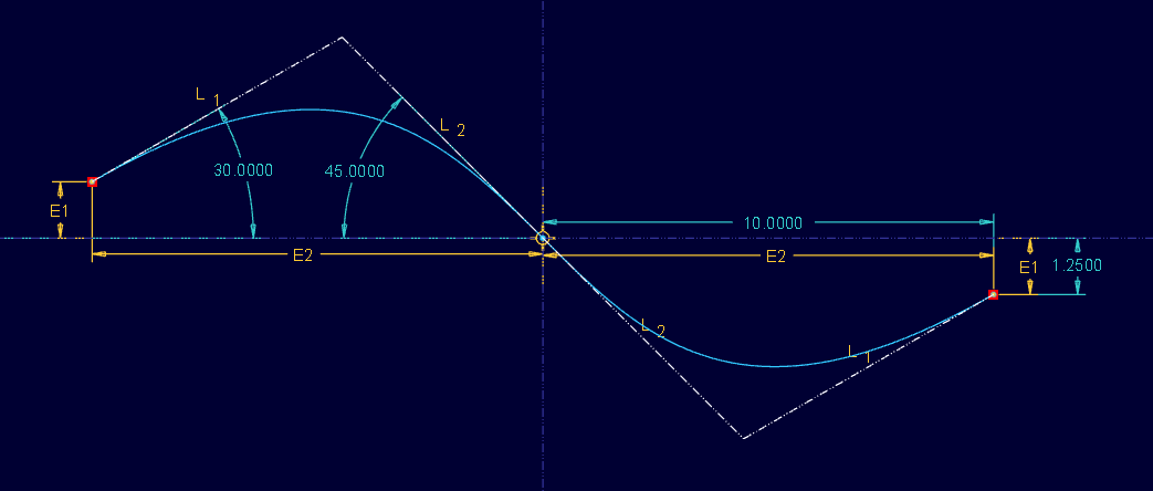

I rarely use splines, so sorry I don't have an answer, but I was trying to learn more about them. I drew this using the polygon control, but it still doesn't look 100% correct as there is a drag handle slightly off center and I'm not sure why.

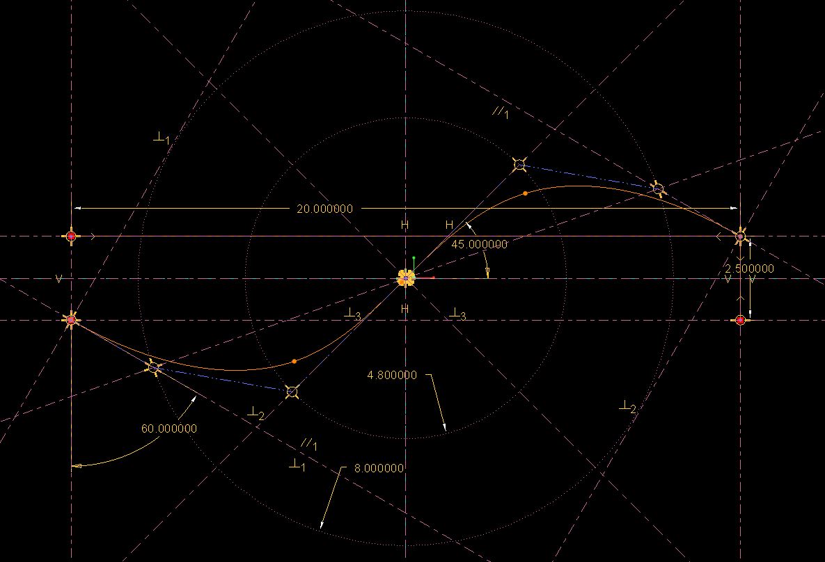

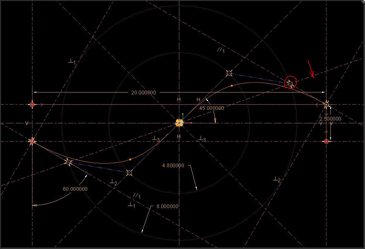

Looks like you're missing an on entity constraint in the upper right to the line indicated.Capture.JPG
January 28, 2014
I thought that, too. but even changing it to this. It's still not right.

Well, I see you guys have a good hard look at it... but you're no closer to a solution than I am.
I see some of the screen shots have extra points added to the spline. That's what bugs me about this - it's a really simple spline. There are only 3 points to it, so the chances of something going wrong should be minimal. The one in the middle is where the 45 degree angle dimension is. The end points are the 60 degree angle dims and that's it, apart for the 20 and 2.5 x and y dimensions.
Doug, I am not able to get any drag handle. Matt, I cannot get polygon control. I click on that icon in the sketch but nothing happens. If I start it from scratch I can't get to the polygon.
I can only assume that ProE treats the start point different from the end point of the spline. It shouldn't. It's supposed to be parametric - the dimensions and constraints applied to the sketched geometry should give one predictable solution

This one works fine... 3 points and edit with control polygons
