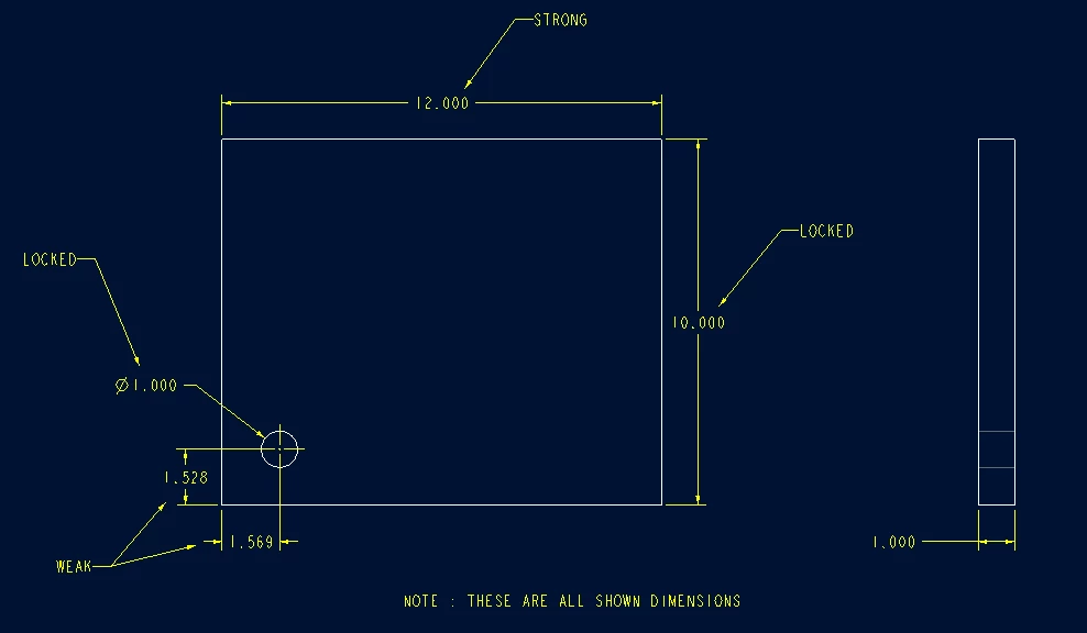

As you sketch, IM will dimension and constrain the sketch automatically.
These dims come in 'weak' and show as gray rather than yellow to
distinguish them from user created dims. The weak dims get replaced
automatically (usually) as you create your own dims and constraints.
Weak is an unfortunate term as they aren't any less capable of
controlling the geometry. Maybe temporary is a better way to think of
them. You can convert a weak to a strong, but not the other way around.

Summary : what is the benefit of converting weak dimension to strong
1. Strengthening them, if I want to keep them, communicates to the next guy (usually me,
6-12 months later) that this is exactly what I want.
<u>I think this is the best answer / reason for converting weak to strong. </u>
2. There's nothing wrong with them, per se, they control geometry the same.
The only functional limitation is that they <strike>will</strike> possible can disappear without
prompting (usually) if there's a conflict between them and newly placed
dims or constraints.
<u>This is true</u>
3. As you sketch, IM will dimension and constrain the sketch automatically.
controlling the geometry. <u>Maybe temporary is a better way to think of
them.</u>
<u>I don't think temporary is accurate more like Intent Manager auto generated dimensioning scheme ?</u>
Below list some statements that were posted and are not correct "in my experience using ProE"
4. On the drafting side of things, the weak dimensions basically become
strong when you place the parametric dimensions on the views.
<u>T</u><u>his is not true in ProE wildfire 4.0 M092, I am not sure about earlier versions or date codes.</u> When I go back into the part and do a redefine feature the dimensions maintain the state they had originally in sketcher mode "weak, strong, locked"
5. First and foremost it allows you to show the dimensioning scheme you want your detailed drawing to show. When you do the show/erase only those dimensions show up.
<u>This is not true, all dimensions from the Sketch show up in the drawing when you use show dimension. </u>
6. Second, making the constraints what you want drives the robustness of the model.
<u>Weak dimension control the design just as well as strong dimensions, if they are attached to the reference that you want. </u>But I agree they should be converted to strong see items #1 above, It lets other designers know you've looked at the dimension scheme and the sketch is constrained the way you intended.
