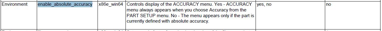

Answer: FILE/PREPARE/MODEL PROPERTIES/Materials/Accuracy and "change" this to Absolute and give it an appropriate value.
So config.pro may set the values, but doesn't activate the Absolute Accuracy toggle. It was -still- stuck at Relative regardless of the config.pro settings.
If you don't see this switch in the Model Properties menu, you might have to set enable_absolute_accuracy to yes in config.pro.

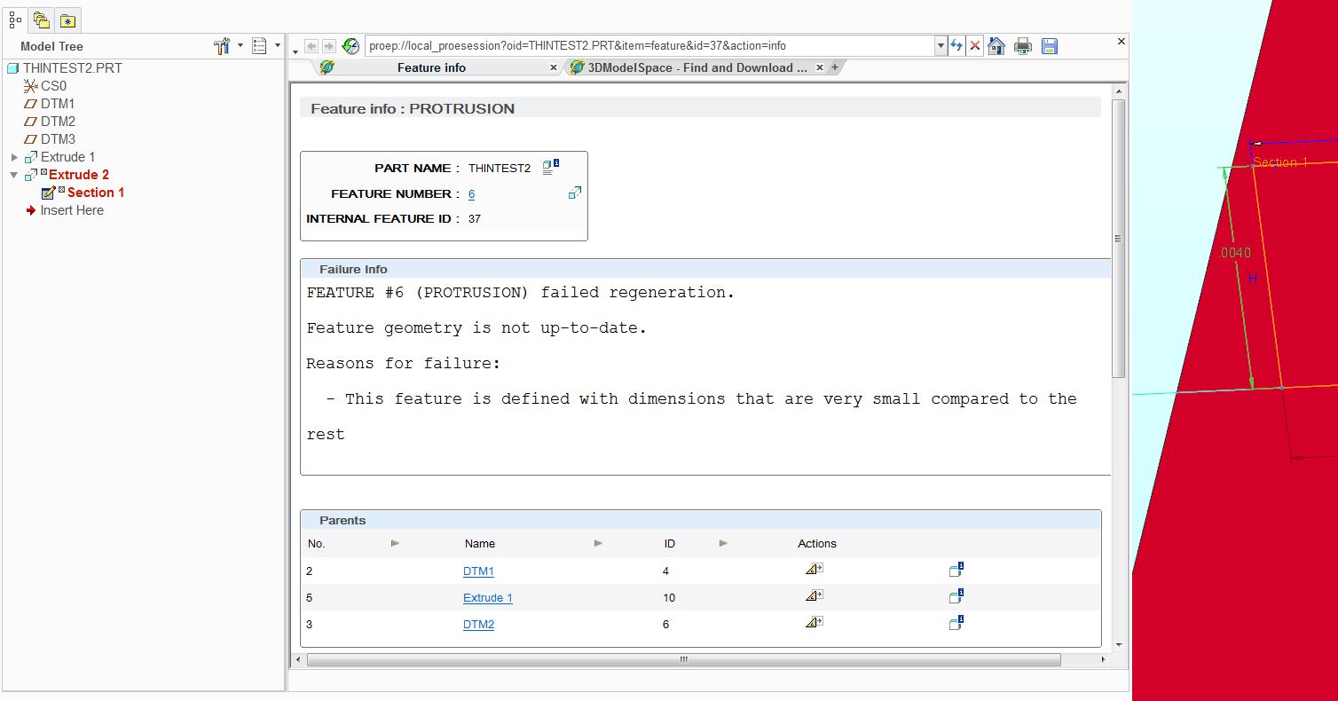

This example is a 19" rack panel (19" x 5.25" x .125") with a thin strip on top.
The minimum thickness I canmake the strip has to be over .004" As I increased the size of the panel, the thickness required kept increasing. Errors aboud if you start changing your part size. This is absolutely insane!
Make a note of the error message in the regen error:
This feature is defined with dimensions that are very small compared to the rest
Who is PTC to decide on what I want for a feature size? I -WANT- .002 thick silkscreen on my panel!

Damn... have you ever seen the "Part Setup Menu" in Creo? I haven't either.
