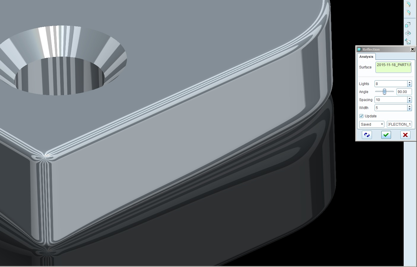

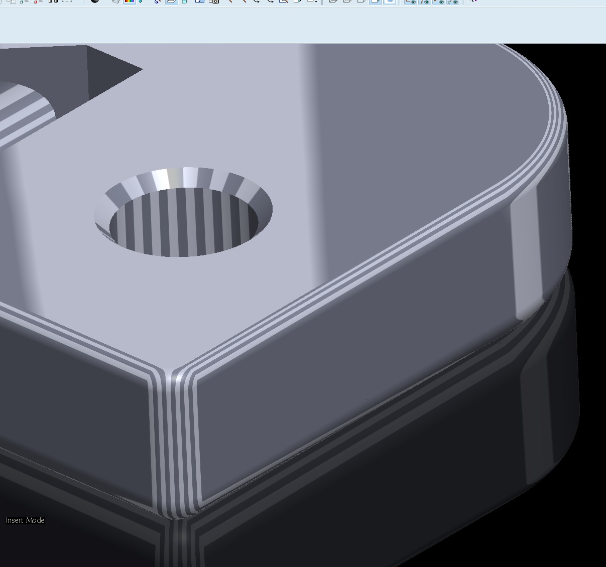

I made 2 identical parts.  In Pro/E I have the ability to define different sets (series of line elements, or faces) of rounds within the same feature, and define the type of round I want.  For each set, I can choose from a section that is circular, conic (with 2 editable parameters), a C2 Continuous (with 2 editable parameters), D1 X D2 Conic (with 3 editable parameters), or a D1 X D2 C2 (with 3 editable parameters).  In SW I only have the option of a conic, and I didn't see a way to add the equation { (sd5 = sqrt(2) - 1 } to create the true arc, and just had to truncate that to .414.
Also, i can sketch a curve on the surface of a part, and can make the radius change to follow the curve and have my choice of section type above.
So, I did a surface analysis of these 2 parts (the reflection analysis tools having a bunch of options whereas the SW "zebra stripes" has none), and the Pro/E part had nice smooth transitions from the planar surfaces, and the SW part had abrupt contour changes everywhere.

Post images of each if you can.
Patriot_1776
November 19, 2015
Pro/E version (C2 rounds):PROE_PART1_SURF_ANALYSIS-01.jpg
SW version (conic rounds):

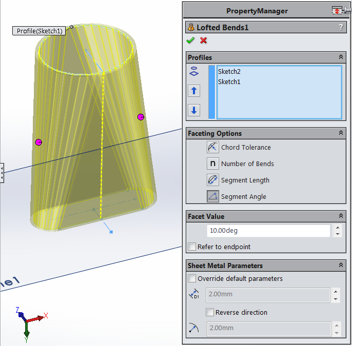

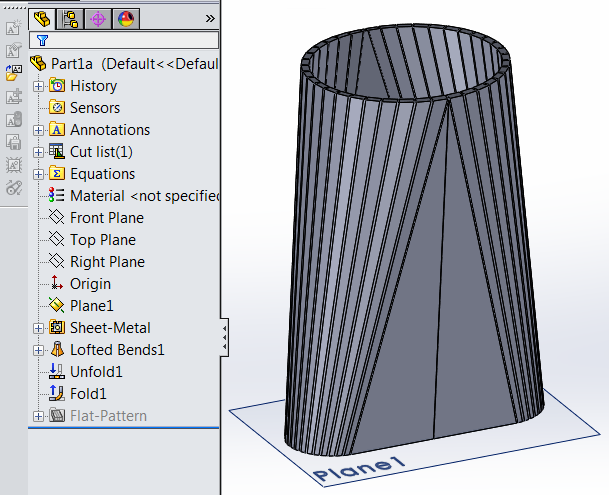

Here is another rather impressive capability.
Have a look under the lofted bends to see how easy it is to tweak the loft with feature parameters.
November 21, 2015
A Blend? Who the heck uses Blends?
November 21, 2015
NO NO !!!  They call it a "BEND" ...not "BLEND"!  Look closely

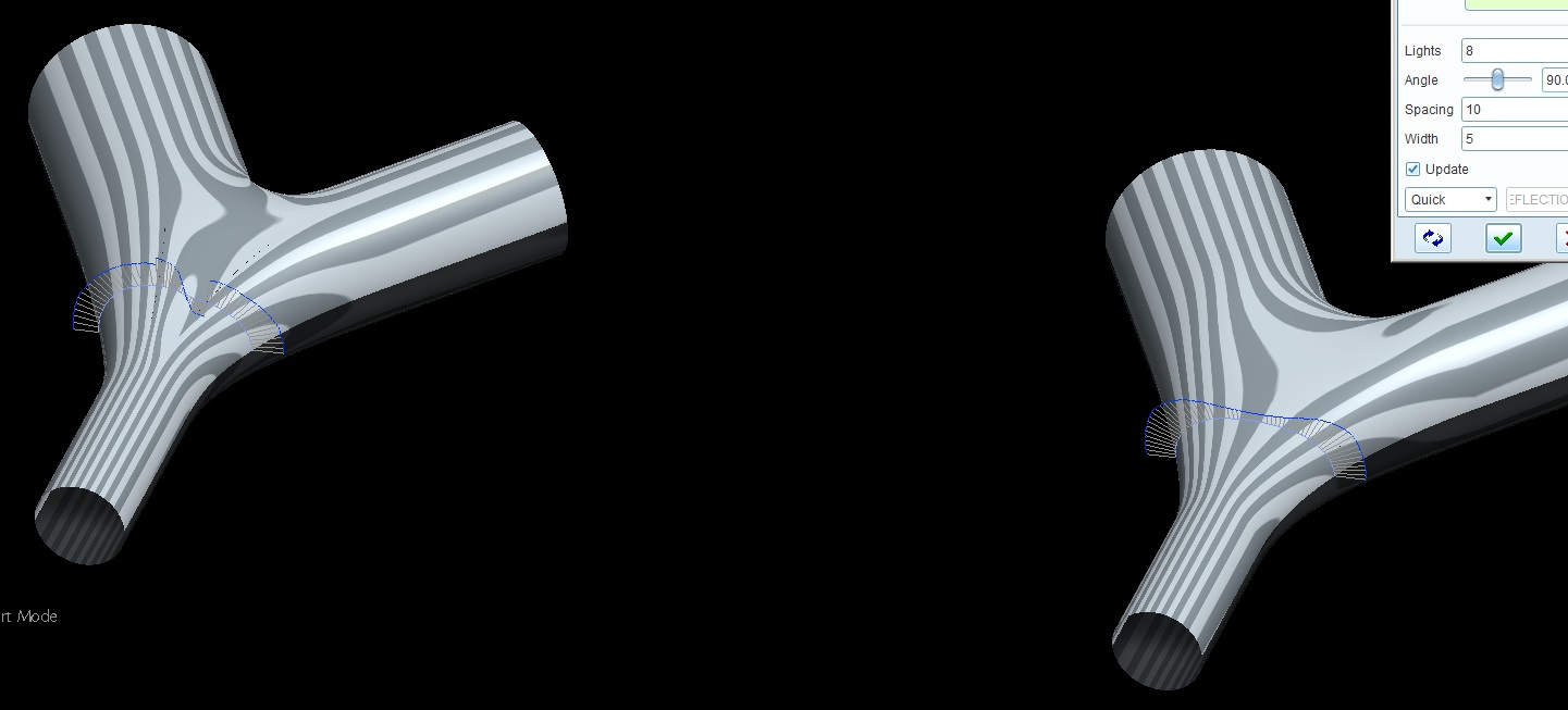

I did a blend in my ancient version of creo, and asked the local guy to recreate the models.  On several of them, he got somewhat close....ish, but that's not good enough for me.  Some were way off.  I can honsetly say he was not able to reproduce a single model the way I had it, and needed it.  Here's an example of part where I joined 3 different diameter tubes at different angles.  In creo, we have an "n-sided Patch", which, while the interface is a little cumbersome when setting up the C2 edge constraints, actually did a great job, in 1 feature.  Nice smooth patch.  In SW, it appears he had to do a bunch of patches (more features, more complexity, more time spent, more fragile), and still couldn't get the smoothness, and even had a pretty bad curvature reversal.....NOT something you want in a mold.  The SW quilt is on the left, the creo part on the right ("zebra" and section curve analysis).

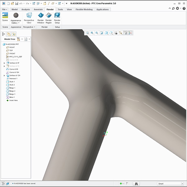

I do that above shape all with four part boundaries and G2 continuity in our one week creo surfacing class BTW.  ill dig it up.  Some of the folks on this forum probably did this model in that class.   Solidworks chokes on models like this with similar workflow because that SW 3d curve tool is so finicky.    Ill post a salad works version the next time I teach a solidworks surfacing class.
