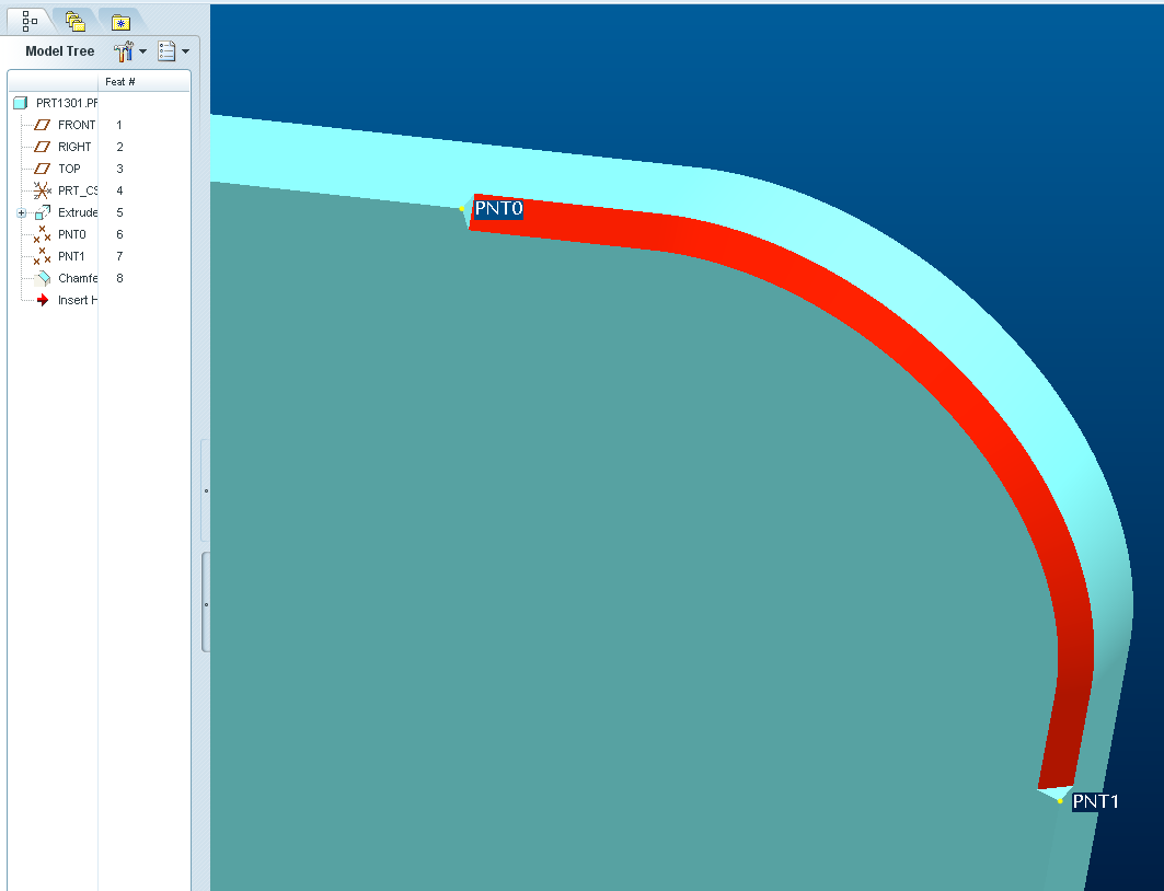

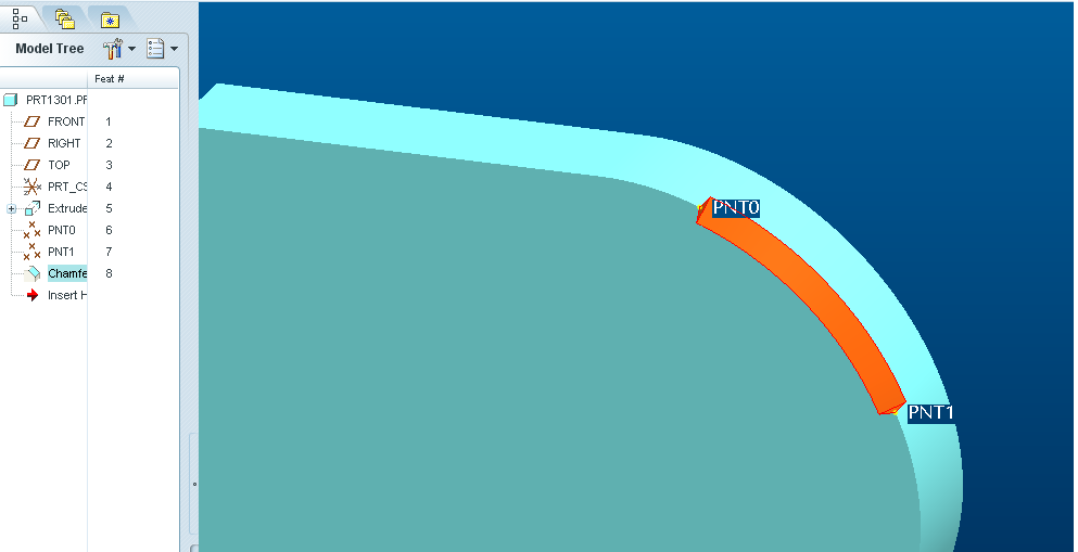

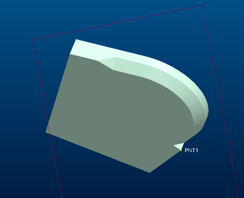

I'm trying to igure out a way to create this chamfer without doing a sweep. Please see image.
I need a chamfer on the edge, between the two points. I can do stop at reference, but can't seem to select more than one point on which to stop. As you see, I need it between two points.
I can't seem to find the option for stop cases, either.
I'm new to Creo Elements/ Pro E 5.0, but have seven years modeling experience. Thanks in advance for your assistance!

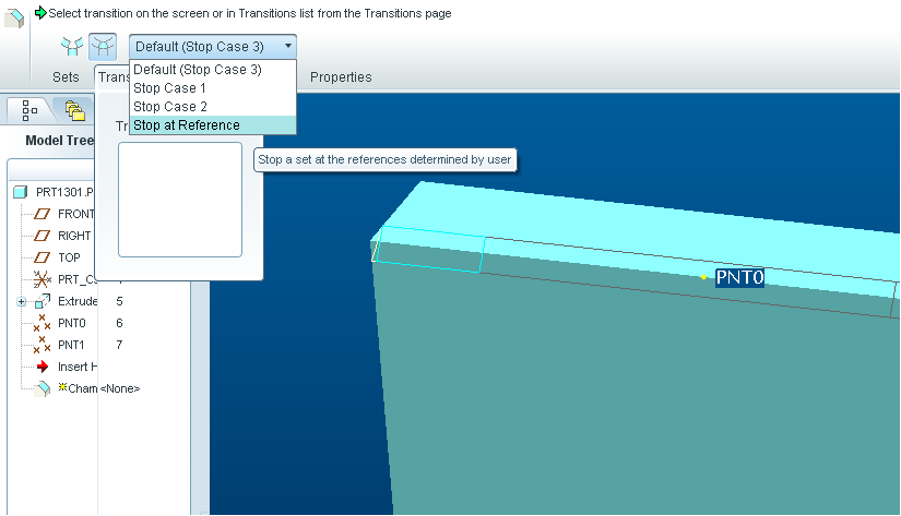

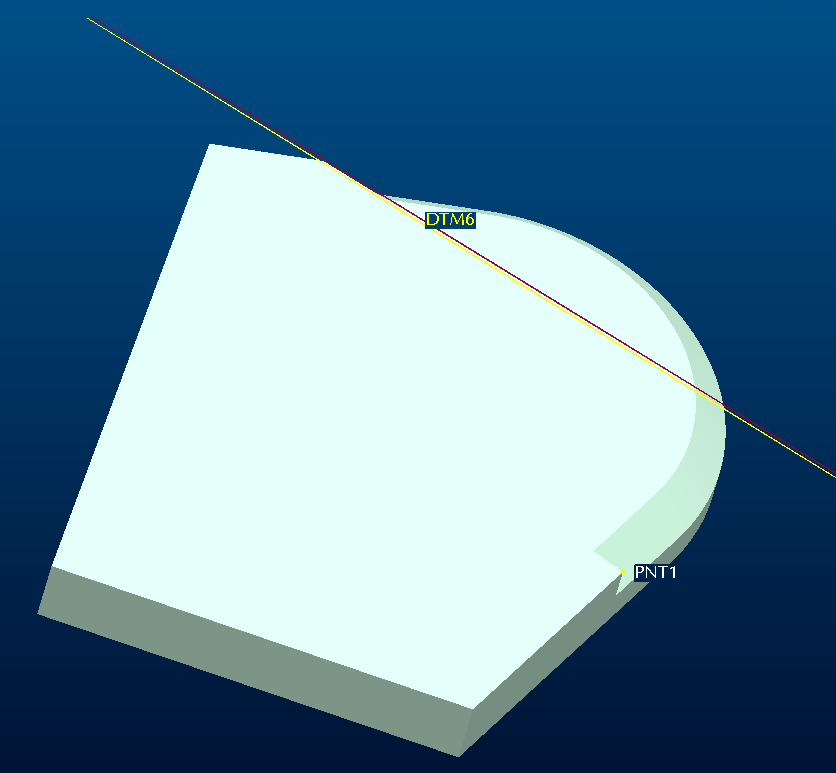

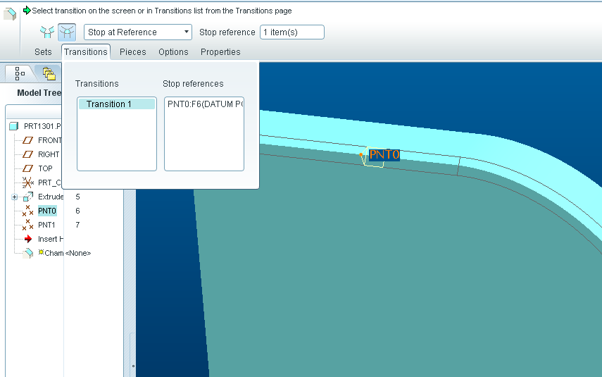

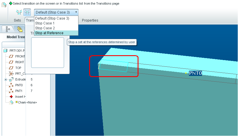

Hi Kris
Chamfer at stop reference has certain limitations
But you can select Plane instead of point for defining Stop Reference( As I have tried in the following image)
This will give you some useful results
I would not say this is a very good solution; But I want to just share some of the Creo/Pro-Engineers Features.
I hope you will find it interesting
Regards
K.Mahanta

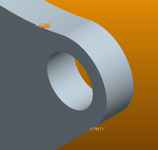

I haven't seen the chamfer command do that before, but if a round would serve your purpose you can use that blue curve on your part as a guide for the round. See "thru curve" option within round command.
But, a sweep would be the better choice. However, don't use "Sweep" use "Variable Section Sweep". It will give you what you want without the cascading menus. Variable Section Sweep doesn't mean that you have to vary the section. It just an option.

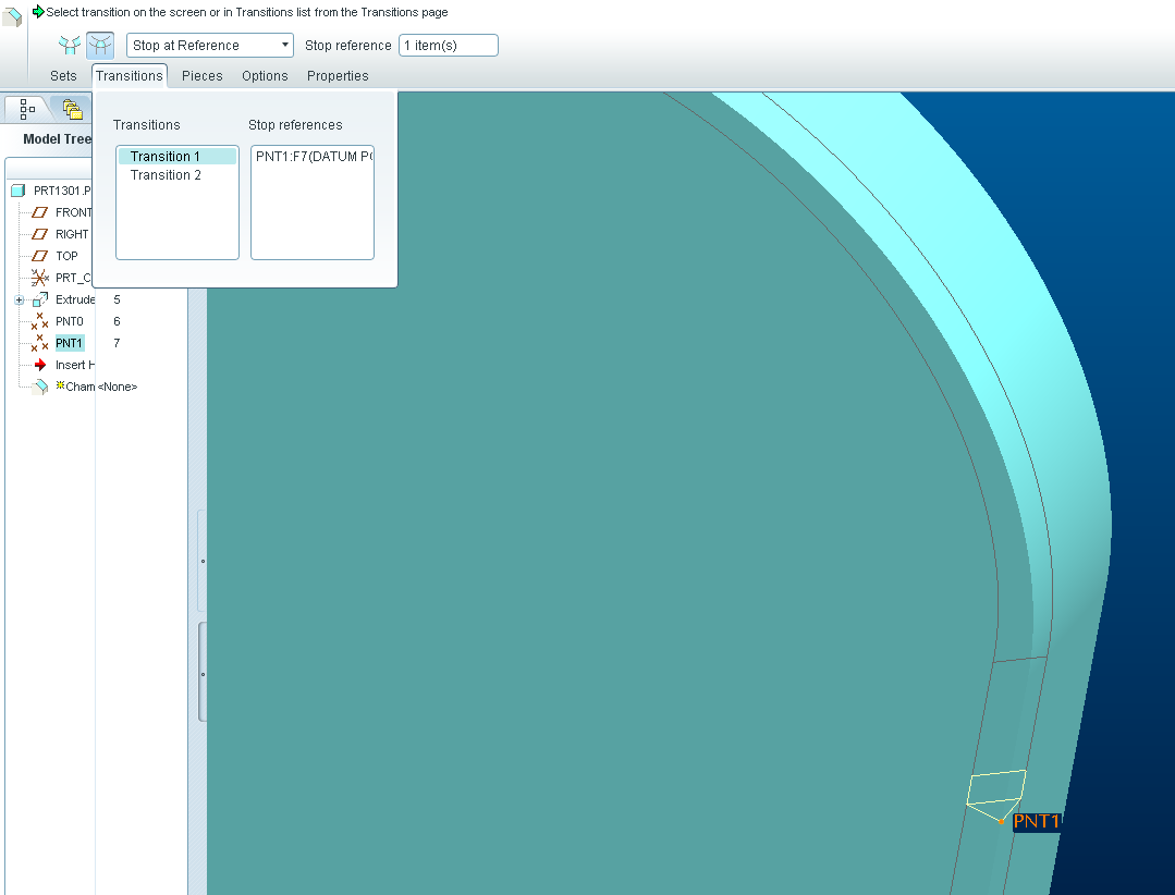

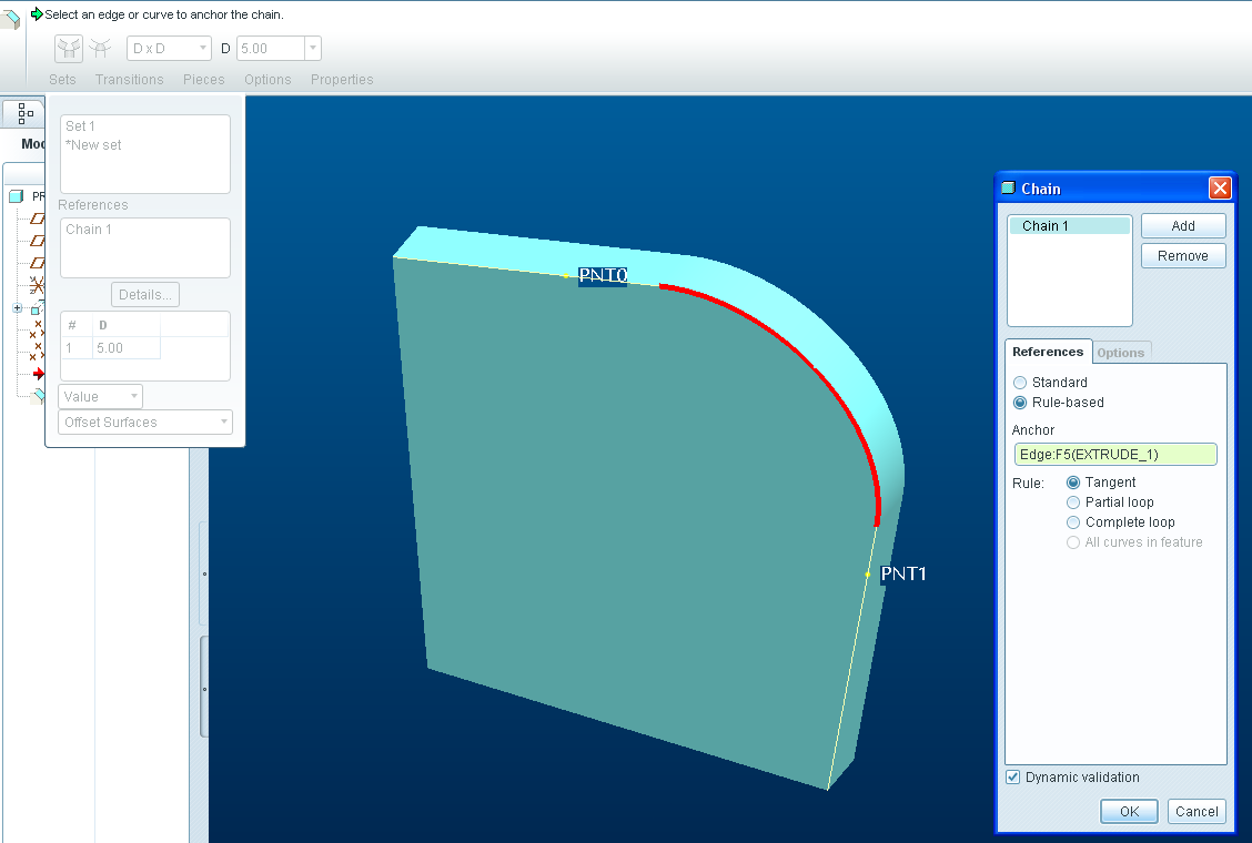

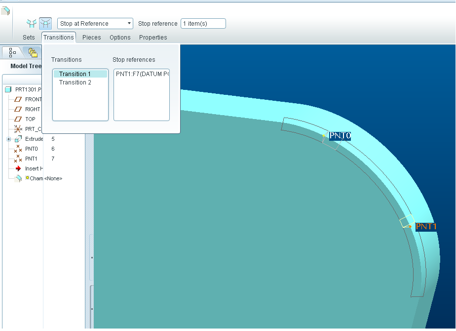

Hi
Do you want to chamfer with in certain limits?
Check the following
This may help you
There might be some more options
(I rarely use these options)
Regards
K.Mahanta

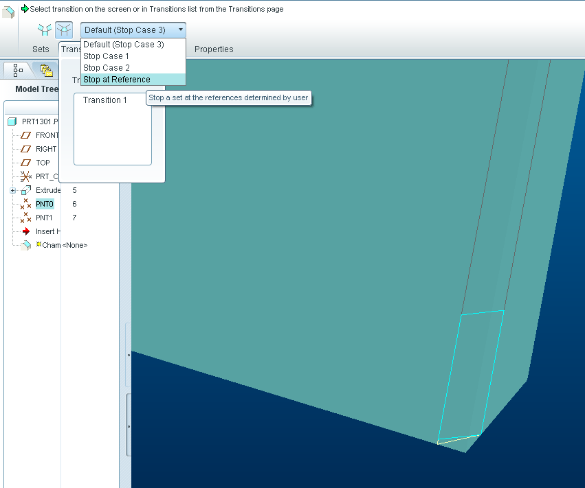

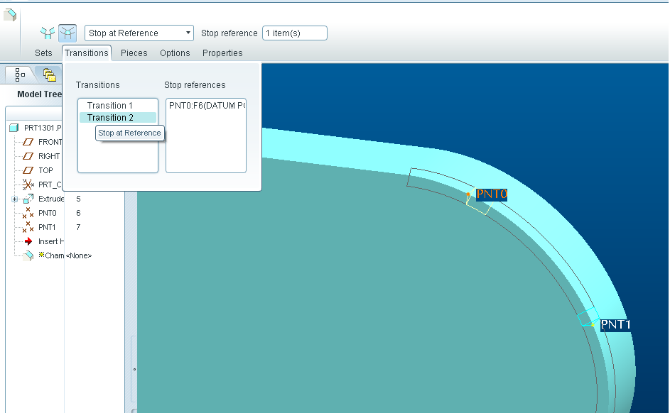

March 24, 2012
Hi
Also check this

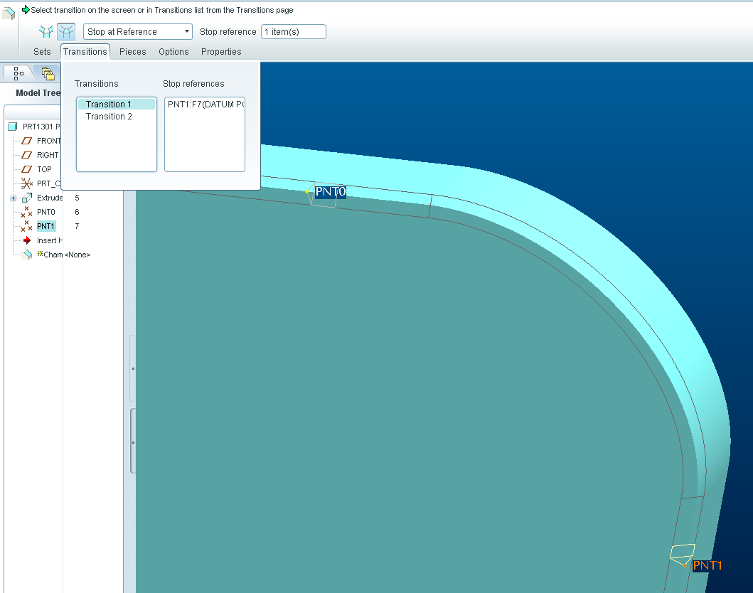

For the end geometry you could create a boundary blend or a filled sketch if you still want to work without sweeps.
March 30, 2012
When I try this, the box where you select the stops is greyed out. I also can't add any transitions. Did I miss something?
March 30, 2012

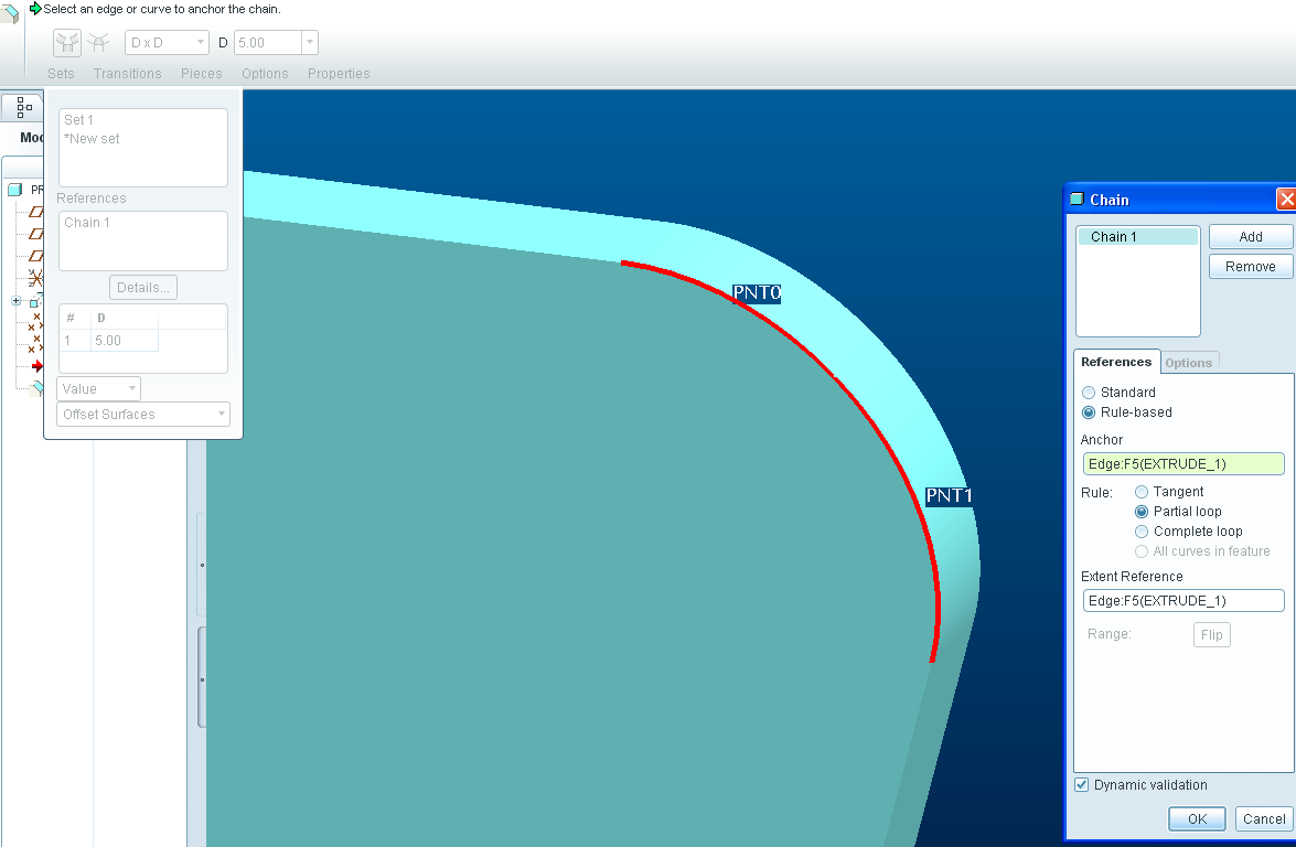

Hi
When you see no options; you have to select end piece (as highlighted in Red Box in the image)
This will enable the options
Regards
K.Mahanta
March 30, 2012
What is that "end piece" that you have highlighted?
I tried your example using the same geometry of two straight edges connected by a radius, and I was able to pick the datum points as stop refs. But, the feature failed when I clicked the green check.
Can you make this same type of chamfer on a cylinder? I was not able to do so.
