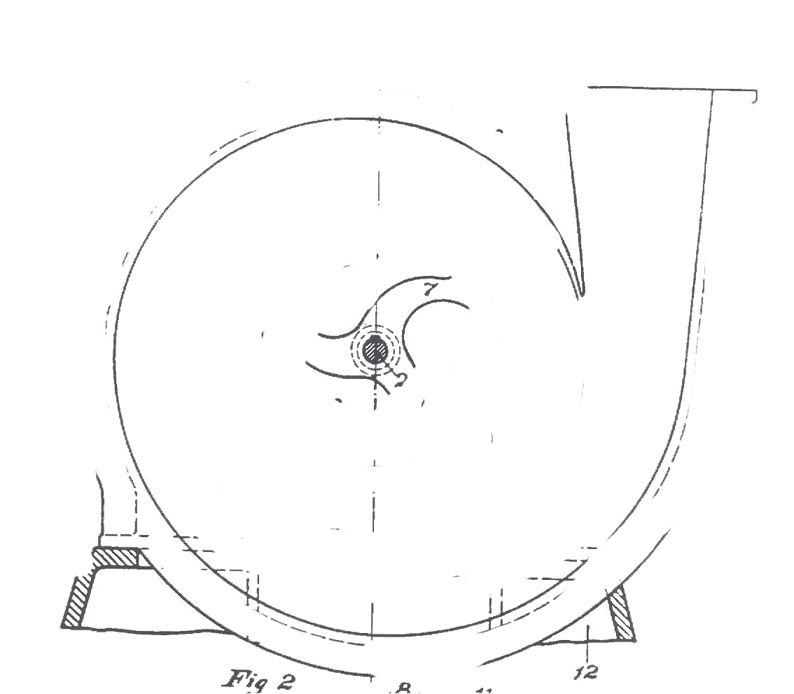

I have spent the last 2 hours, working on tracing a curve from a jpeg image that looks like logarithmic spiral or some similar curver.
Tracing with styling feature cannot give me the accuracy that I need, as the final model will go to cnc for prototyping. (PLS see attached prt)
I would like, to show you this jpeg image and kindly give me your feedback; how to trace or design the curve of the housing with an equation!

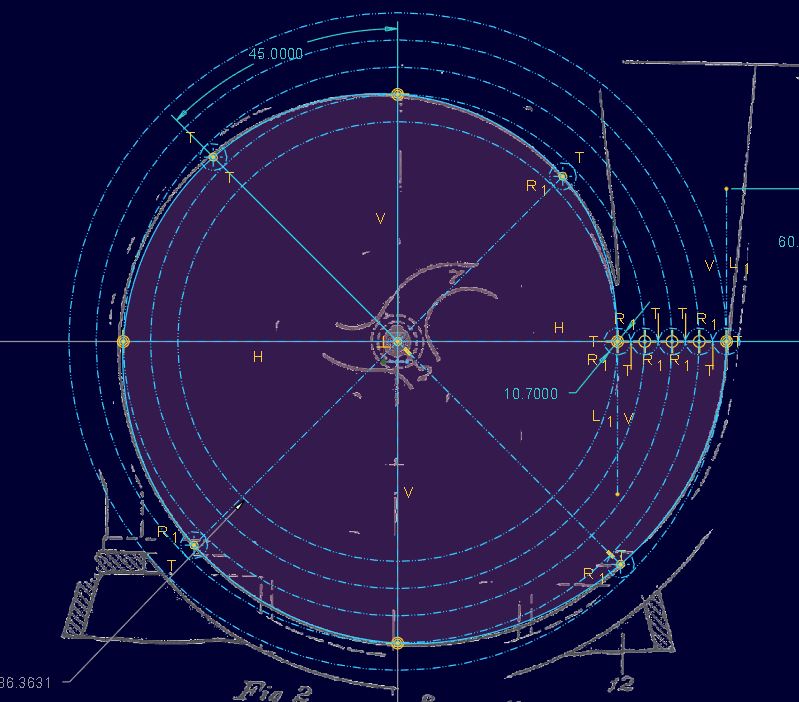

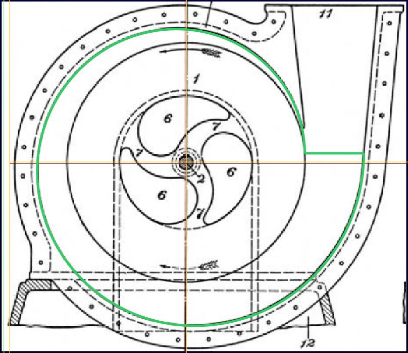

Play with the center some more. If you place the shaft of the drawing at the datum intersection, you will be able to scale the image to fit the curve.
The image I included shows as 20.47 high and 17.71 wide in the image dialog. I had to rotate the image 90 degrees CW. I just duplicated the effort and the values came out the same. The center is located on the default datum plane intersection. Here is a more detailed overlay:
I don't think that any equation can fit the original sketch any better. I will again refer to the use of french curves to document to original patent application. It is hard to tell how accurate the original prototype was cast as well. Regardless, the functionality could have been sufficient albeit not optimized.
There may well be a much better profile based on pressures in particular zones. It may not follow this curve at all. Today, most turbo pumps use a common profile that expands in all directions proportionally.

1st, I am going to suggest that the image is not exact. Most likely drawn with a french curve as close as someone needed it for conveying the idea. Obviously not perfect for functionality.
2nd, I would suggest you make a proper curve through a complete 360 degrees. You can use the image as an underlay to get "close" but trust the equation rather than the sketch.
3rd, Use tangency, mirrors, and fillets to complete the geometry for the "flute".
..and I learned that images do not carry forward with zipped part files. Using the image jpeg from the post also did not show up. I had to make a PNG and place it to make it work. Not even naming the jpeg properly would show the image in Creo 2.0. Another bug?
December 24, 2012
This is a poor man's version of the turbo curve. 8 points at 45 degrees on equally spaced concentric circles and tangent ends on the spline.

In case anyone else is following this, have a look at Tesla's original patent on this pump:
http://www.teslauniverse.com/nikola-tesla-patents-1,061,142-fluid-propulsion
January 2, 2013
This this the original source of the drawing. However, the project goes much further than this based on that jpeg photo.

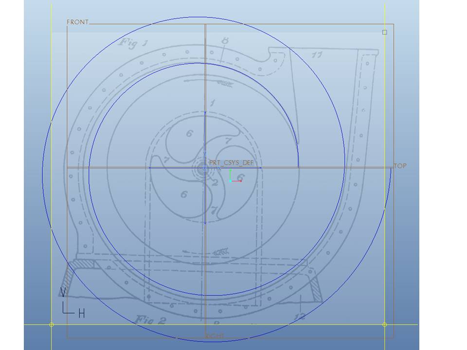

January 2, 2013
Trying to align the photo (playing with scale) with the datum curve - from equation- I cannot get your result.
The curve made from
r = 6 + t * (8 - 2)
theta = t * 360 * 2
z = 0
give as concentic circles while in Tesla's dwg it is kind of involute or sth....
Pls see below attached .... The datum curve in blue does not match with scaled image . I know that is not a perfect aligment but I can see that no matter moving I do, there is a slight difference in the geometry.
Where I am mistaken?

I think it is an image scaling thing... I was very careful to scale using the corners so as not to change the aspect ratio. I am sure you did also.
I have attached the part and the image. If you unzip both files in the same folder, it should open properly with the image in tact. I had trouble doing this with your original version. Please let me know if the image comes in by default.
January 2, 2013

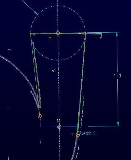

Also unhide sketch 2 and see something interesting with regard to "implied center".
I need to take that idea further and see what I find.
January 2, 2013

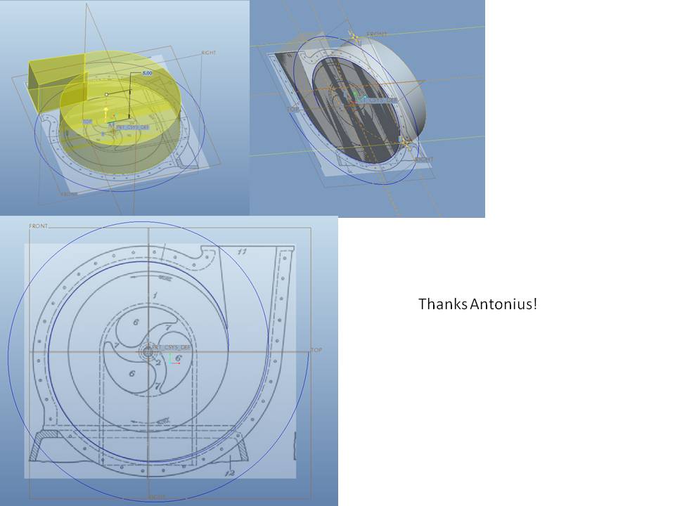

You were right!
Now I need to get the details for the flute....As you said , it is just a tangent line ....Reverting with that as well.
January 2, 2013
It was an interesting problem. Glad I could help.
