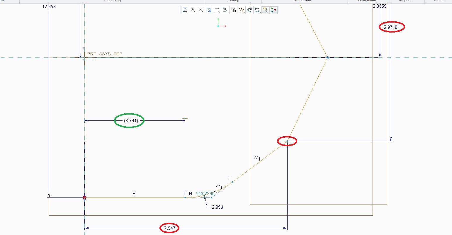

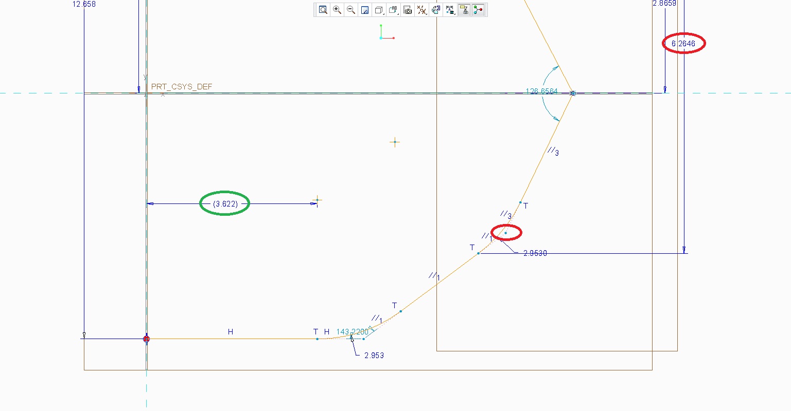

I'm having a lot of difficulty in figuring out how to keep the constraints in sketches from floating around. I can go line to line with all the appropriate sketch dimensions but things start to skew when I add a radii. The radii may place correctly initially but the dimensional constraints start to distort. Since I can't just initially place the radii to what ever size I want it requires an additional step of modifying the radii. This modification always makes the other geometry lose it's position. I can prevent the size distortion if I reconstrain the 1st radii's placement, but I already constrained everything prior to the radii blowing away my dimensional constraint.
I will attach the progression that I am frustrated with.

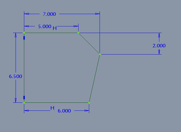

In looking at the above sketch I have things the way I want it. There is a horizontal and vertical dimension placing my position. There is a point at the intersection.

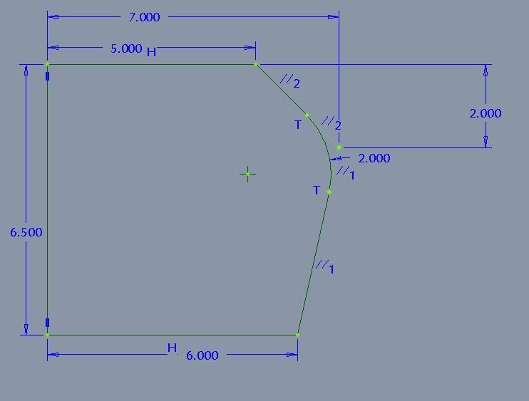

Next; I will need to add my radii.
Above you can see my dimension scheme starting to unglue. My horizontal dimension has been removed. The vertical dimension now has shifted to a tangency on the radii I just added. (That doesn't help me at all). Circled in red you can see that the original point which had the horizontal and vertical dimension is still there, but it lost it's 2 strong dimensions.

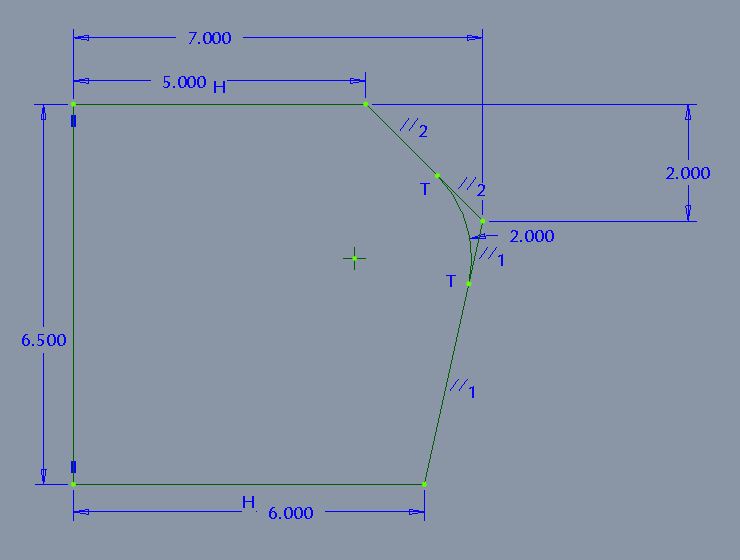

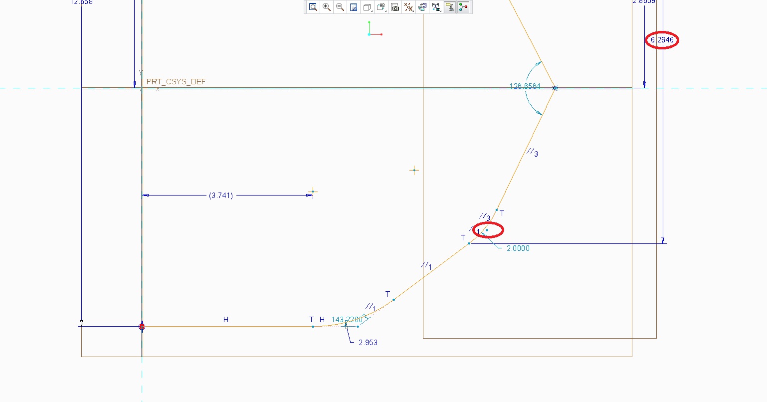

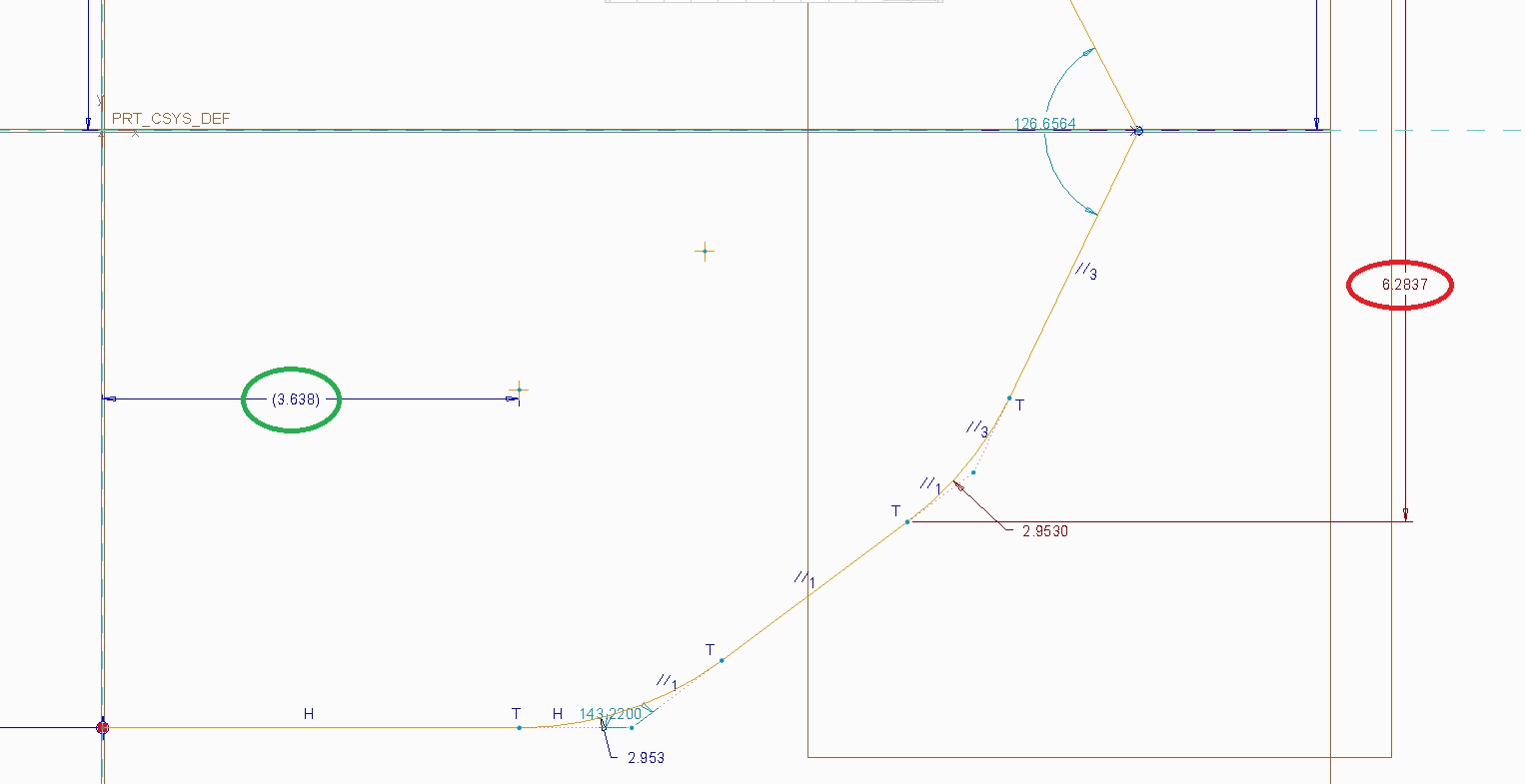

I'm not done yet; I have to modify the initial radii to the size I actually need.
As you can see above not only does the sketch retain the useless vertical dimension it also shifted the placement of the dimension shown in Green.
As I see it there is only 2 choices here 1) have size distortions or 2) add extra steps in reconstraining dimensions that were removed with the radii placement.
I have submitted an idea for not having to double enter the radii, which would prevent some of the problem here. http://communities.ptc.com/ideas/2028
There is another idea submission which addresses the removal of the 2 dimensions with the radii placement. http://communities.ptc.com/ideas/1006
Not too many votes for these submissions which makes me wonder if there is an alternate but less intuitive way of placing the radii.

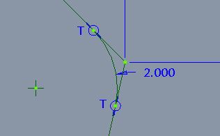

Here is the way I use to do that:
1. Draw your sketch without any fillet:
2. Draw an arc, tangent at both ends:
3. Divide the two staight lines at tangency points:
4. Convert the resulting lines to construction entities:
Done !

How do you create your Arc? I tried the Arc using 3 point Arc but even though a good solution hilights it won't drop. I tried as a tangent end arc, but it only gives me tangency on 1 end.
December 5, 2012
3 points/tangent arc which is tangent at one end, then add a tangent constraint at the other end.
EDIT: I'm using Creo/Pro 5.0
