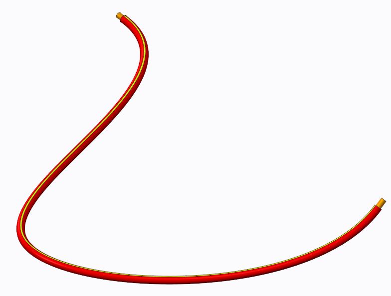

From what I understand it's not possible to have two-colored (striped) wires in Creo and the Cabling module, but does anyone have a workaround for this?

November 21, 2013
Like this?
This is more cosmetic and definitely not automatic...may be more work than it's worth. Here are the steps I did to create this, albeit NOT in the cabling module so your steps may vary:
  1. Color the outer surface of the insulation 100% transparent.
  2. Create a copy of the surface.
  3. Create two sweeps that are the equivalent of the stripe thickness.
  4. Trim the copied surface with the sweeps.
  5. Color the trimmed surfaces the colors you want.
See the attached file (Creo 2.0) for how I did it.
Patriot_1776
November 21, 2013
Well, all I did, was when I swept the secction, I made the section have another surface at the sketch level, an arc with the same center point, just raised a couple thousanths. You could do it by offsetting, but I think it's simpler this way, especially if the wire really twists around.
