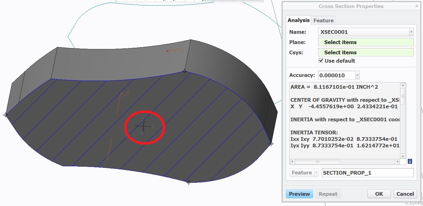

What I need is a centroid point to a closed area in a sketch.  It doesn't appear this is possibly directly.
If you build a solid feature off of the sketch you can visualize the center of gravity through choosing X section Mass Properties.
Unfortunately I can't appear to save the result.
If I go the Feature tab the option to save the result is not available (it is greyed out).
Would anyone have an idea of how to get this to work properly?

To use analysis features, you need an "advanced" license (can't remember the names right off hand). Then you can create a feature.  COG coordinate system
There is another method that takes just a little more work.  Center of Gravity in Drawings

If you click on the "i" button you will get something that you can save.  However, you can leave that window open to cut and past the numbers into your Point - Offset Coordinate System.

As Stephen alluded to up above to be able to actually drop points from the analysis you have to have the BMX license.
This seems insane that you have to use this crazy work around to actually place a centroid point in a sketch.  Oh, and by the way you need to purchase an otherwise un-needed software add on to do the crazy work around.
There is absolutely no reason this shouldn't be in the product's base functionality.

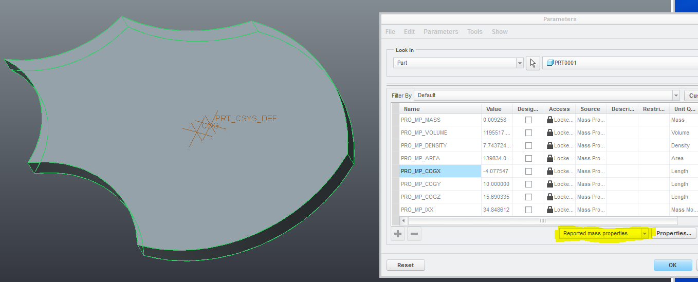

to obtain a point automatically placed at COG you have to create an offset datum point starting from the default coordinate system and then add theese simple strings to the relations:
$d1 = mp_cg_x("","DEF_CSYS","")
$d2 = mp_cg_y("","DEF_CSYS","")
$d3 = mp_cg_z("","DEF_CSYS","")
where d1, d2 and d3 are the names for the point offset dimensions and DEF_CSYS is the name of the default coordinate system.
Note: you need some geometry and mass property to validate the relations.

Hi, It's not so difficult to generate the COG. Create a new Csys from the part or Assembly origin Csys in the X value you simply type pro_mp_cogx in the Y you put in the value pro_mp_cogy and in the Z you type in pro_mp_cogz. These come from your reported mass properties in Tools/Parameters.
