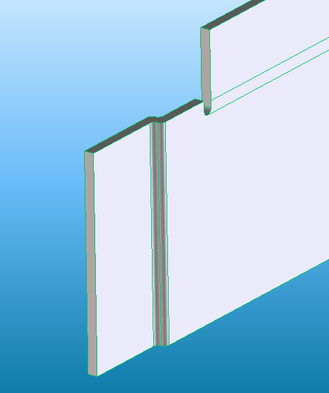

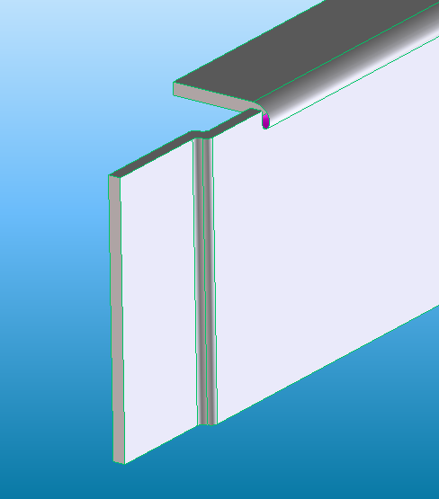

Is this a known issue?
When using Unfold Part, the Offset Lip does not unfold.
See attached pictures.
Mike
January 7, 2016
How did you model this offset lip ? Usually when I design something like this it unfolds.
mmaenpaa1-VisitorAuthor
January 7, 2016
Hi Raphaël,
I didn't do anything fancy, this was just a test part I made after a co-worker with a more complex part pointed out the problem.
It's just a flat face, then I added a lip, then used the Offset tool.
Mike
