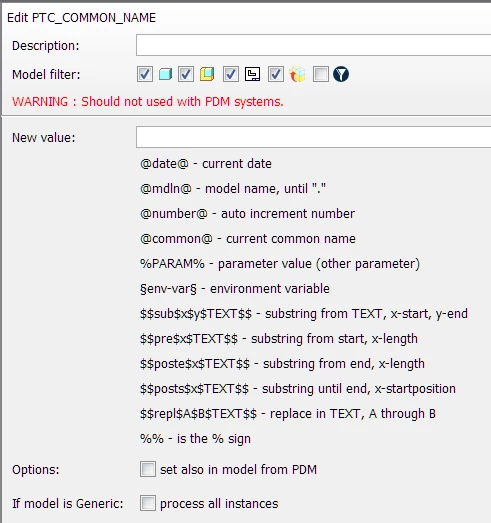

There is another tool I've been playing with lately that can do the
check for you, I just don't know what integration functionality it has
with Windchill. (I know it has some, just not the specifics). Model
Processor from INNEO (modelprocessor.inneo.com). This is what the one
function for editing the PTC_Common_Name looks like (other report types
functions from MP may be preferred though);
