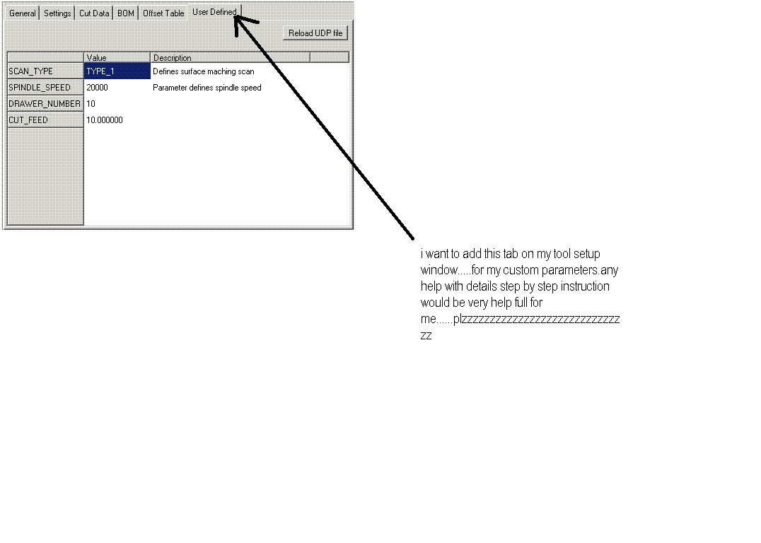

HELLO EVERY BODY FISA HERE
I HAVE A LITTLE ISSUE WITH USER DEFINED TOOL PARAMETERS
....I NEED TO ADD SOME CUSTOM PARAMETERS ON MY
TOOLS....BUT CANT ABLE TO DO IT....NEED HEELP REGARDING
ITT..PLEASE CHECK ATTACHMENT FOR DETAILSSS..

You have probably made an error in the file. It has to be perfect to work.
Check this
https://support.ptc.com/appserver/cs/view/solution.jsp?n=CS172317
/Lars

I was trying to help one of my customers with the problem that cut data saved with the tool was read wrong when you use auto copy of cut data (parameters) from tool to sequence. This in the case that you have a metric nc model, cut data saved in metric and trying to create a hole tap sequence. In this case the "thread_feed_units" always default to TPI instead of MMPR. And Creo is so smart that it will convert the data from the tool when its read in,from MMPR to TPI. SO to make it work you need to change the paramater to MMPR before you select the tool.
I did give him 2 suggestions:
1: use a site file (did not work he claimed, but I think that he had forgotten to activate it in both places)
2: add THREAD_FEED_UNITS as an extra parameter using the "user defined tool parameter" file.
But instead he recalculated all feeds so they converted correctly to what he needed.
I saw that the discussion was old, but since I came across it when I was looking for info in CS KB, I decided to give an answer for future users of Creo with the same problems. The manual provides guidance about how it works, but since the file example is added in the page as a picture its not possible to copy as a template.
