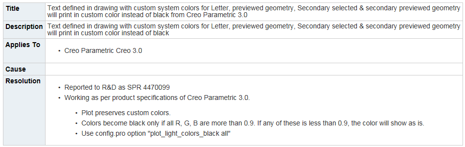

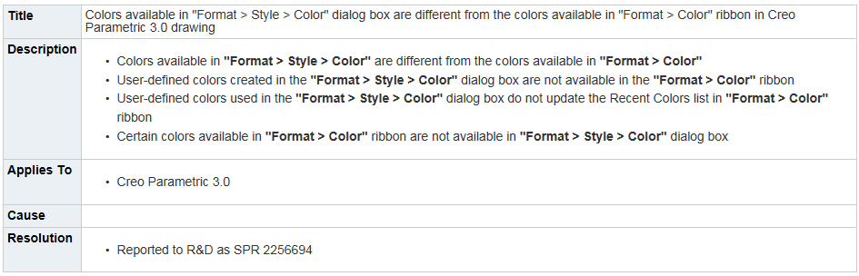

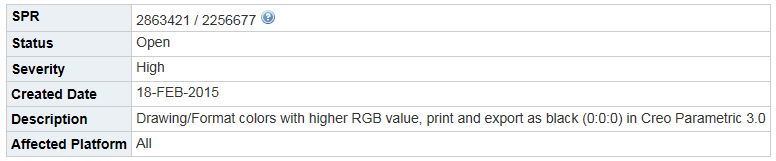

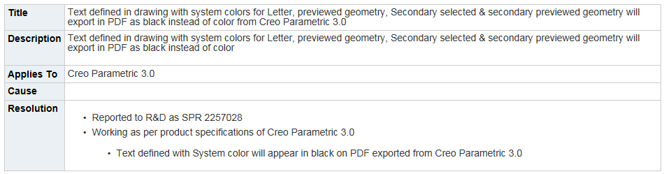

Here are the actual articles and the related SPRs.  The specific issue you mentioned is the second one in the list below.  This effectively kills a users ability to use a custom system colors file while still allowing the system to reliably print in color.  Changing the underlying RGB value of a system color (to accommodate a user's display preference) shouldn't alter the actual plot output!
CS199096 (SPR 2863430)
CS209639 (SPR 4470099)
Case Only - No Article (SPR 2863421)  [By the way, this is when all RGB values are higher than 130.]
CS198788 (2864180)
