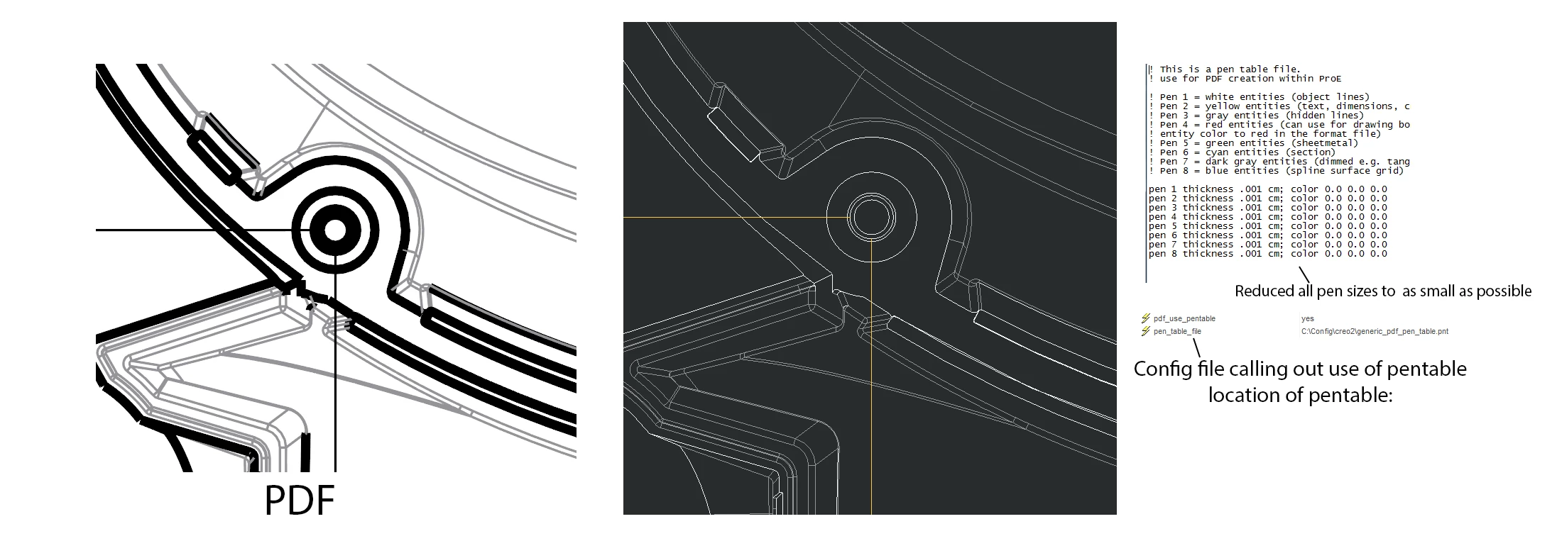

Venting time, why is PDF export still so terrible? Even using a pentable (the work around for the last few years since it has been broken) with the pens sizes turned down to pretty much zero the drawings are aweful. Is it too much to expect for this to work?

The attached image shows pentable settings, location, config options and a comparision of what is being seen when exporting a pdf and what is on screen. All pointing to the right place with all pens turned down to 0.001cm!
The PEN Table may not be working as all the pen thicknesses have been set to be the same thickness, the weird thing is that this has worked previously. I wonder if there is some other setting overiding the pentable? I have had that previously when we changed to creo 2 and we had some setting conflicts from our standard settings causing unusual behaviour. .

Remove those entries from the config.pro and make a file named
table.pnt
Add the following to the file: make sure the file does not have a hidden .txt extension
pen 1 thickness .002 in
pen 2 thickness .002 in
pen 3 thickness .002 in
pen 4 thickness .002 in
pen 5 thickness .002 in
pen 6 thickness .002 in
pen 7 thickness .002 in
pen 8 thickness .002 in
Place the file in your working directory (folder).
Use the export to PDF dialog and check the Use Pen Table option in the option dialog.
Now export the PDF.
This worked for me on this file using 600-PDI setting:
That is a 1/8" ball at 1:1 on an A-size drawing zoomed 800% in Adobe reader.
EDIT: I only suggest you try this method 1st to make sure you can get the output you want. After that, follow the steps of the other replies to integrate the settings into your default configuration.

I had a lot of trouble getting PDF's to plot correctly, too. Here is what I ended up doing:
Put the following lines in your config.pro file:
pdf_use_pentable yes
use_8_plotter_pens yes
pen_table_file T:\Engineer\Library_Proe\6_Creo2_System_Files\config\Plot\pen_table_pdf.pnt
"T:\Engineer\Library_Proe\6_Creo2_System_Files\config\Plot" is my path to the "pen_table_pdf.pnt" file.
The pen_table_pdf.pnt is just a text file that contains the following lines:
pen 1 thickness 0.005 cm
pen 2 thickness 0.005 cm
pen 3 thickness 0.005 cm
pen 4 thickness 0.005 cm
pen 5 thickness 0.005 cm
pen 6 thickness 0.005 cm
pen 7 thickness 0.005 cm
pen 8 thickness 0.005 cm
For plotting to the plotter or printer, we use the default MS_PRINT_MGR. The ms_print_mgr.pcf file has a line that calls for the pen_table_ms_print_mgr.pnt pen table file. Make sure to use the correct paths to your file locations.
