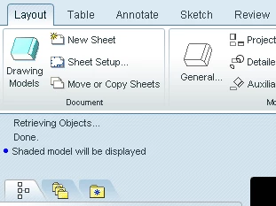

PTC, please, add a Layer button to the right of the "Drawing Tree"
heading.
Clicking on the paper list icon, then clicking Layer Tree is so stupid
when it could be one click right there.
Alternatively, add a Layer tab between the Model Tree and Folder Browser
tab.
One more thing; why is there so much room for the scrolling comments
when the ribbon is only half the width of my screen? The comments could
be in a window/toolbar that can be positioned and sized per user. A
third of my vertical drawing screen is menu. I may as well get a square
monitor again.

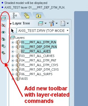

number of clicks to get to them. In the meantime, you could consider a
simple customization to your toolbars that would provide the same
benefit you're looking for and even more. That is to add a new toolbar
to the right of the Drawing Tree/Model Tree that contains the commands
to active the Layer tree as well as those for setting visibility state
and saving and resetting of layer status. I find this to be very helpful
and doesn't eat up too much real estate on a widescreen monitor...

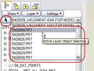

In Wildfire 4.0, here are a few things you could do... To pull up the
layer tree while assembling a component, just select on View > Layers
from the top level menus. This should make the layer tree visible, then
you can filter the tree to the component being assembled by either
selecting the component from the pull-down list above the layer tree of
by clicking on the Select icon and picking the component in the graphics
window (easiest way).

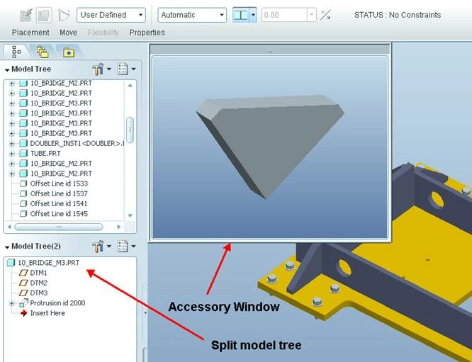

In Wildfire 5.0, we've added even more improvements, such as including
the component being assembled in the model tree appearing below the
Insert Here location. You can select references right from the tree.
We've also added something called the docked accessory window which is
an improvement over the old separate window in that it does not keep
falling behind the main window. When you have the accessory window
active, we've also implemented a split model tree that shows the
component being assembled in a separate tree so you can select
references from the tree.

Thanks for the tips. It looks like you have the visibility features on
a left side tool bar, and then you added the layer command to the top of
this.
Using WF5 m040, the visibility toolbar is blank. I will add the
visibility items to this toolbar and dock to the left side.
The layers and selections do work in assembly, thanks for the info.
