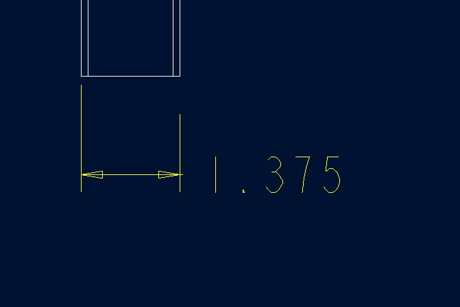

I have a dimension where one witness line was dragged from it original location. Is there a way to "reset" where this belongs?
(WF5.0/Creo)
Thanks, Dale

As there is no option to rest, you may try moving such diemnsions to any another view and back to original view.

I was hoping for something like insert jog/remove jog. No luck.

Try this:
Select dimension + View (Using CTRL) > Drag the handle of witness line.
