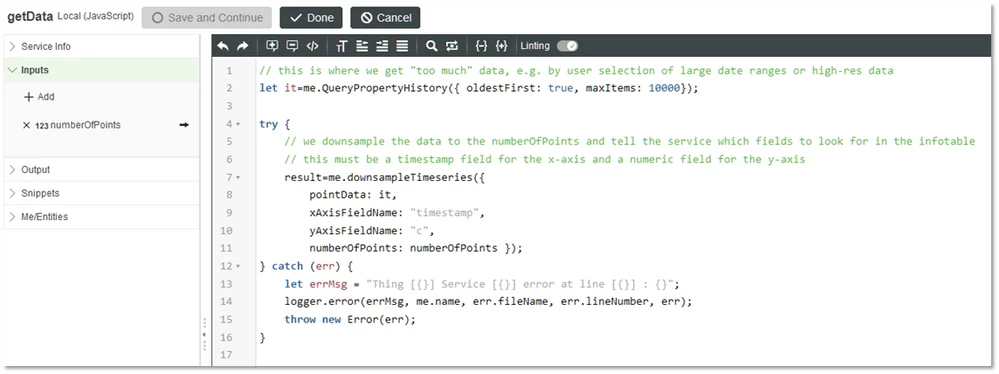

Example: Downsampling timeseries data for mashups using LTTB
In this post, I show how you can downsample time-series data on server side using the LTTB algorithm.
The export comes with a service to setup sample data and a mashup which shows the data with weak to strong downsampling.

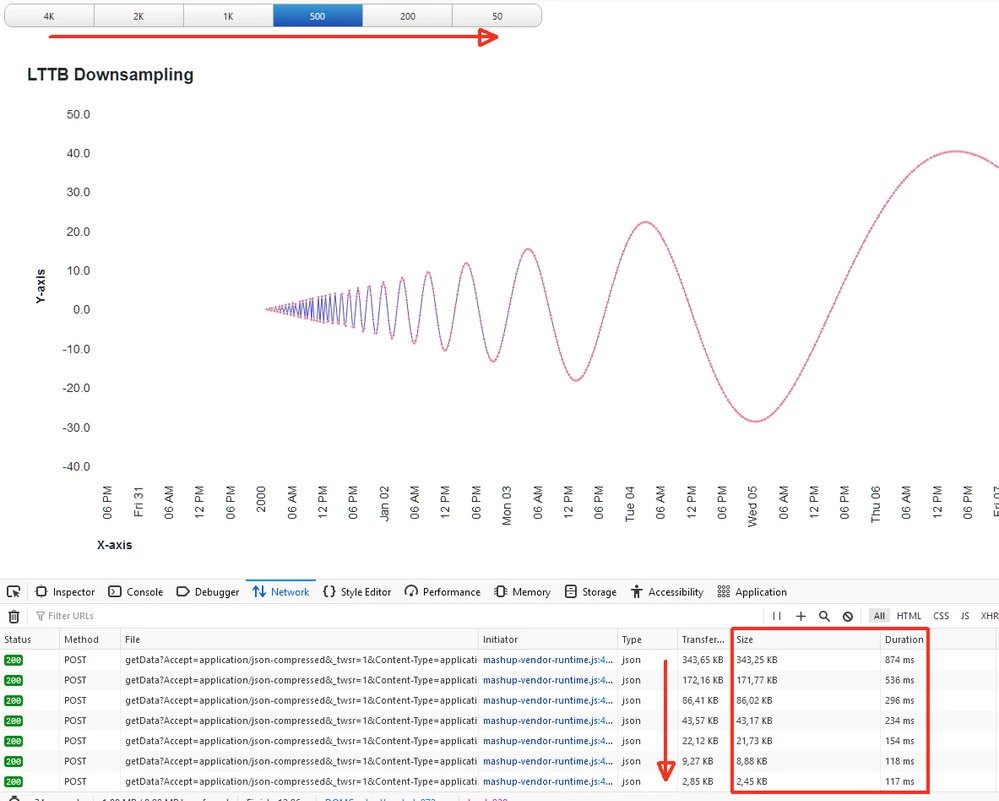

  • Open mashup LTTB.Sampling_MU:
    • Initially, there are 8000 rows sent back. The chart widget decides how many of them are displayed. You can see the rowcount in the debug info.
    • Using the button bar, you determine to how many points the result will be downsampled and sent to the client. Notice how the curve get rougher, but the shape is preserved.
  • How it works: The potentially large result of QueryPropertyHistory is downsampled by running it through LTTB. The resulting Infotable is sent to the widget (see service LTTB.TestThing.getData). LTTB implementation itself is in service downsampleTimeseries
Debug mode allows you to see how much data is sent over the network, and how much the number decreases proportionally with the downsampling.
LTTB.TestThing.getData;
The export and the widget is done with TWX  9 but it's only the widget that really needs TWX 9. I guess the code would need some more error-checking for robustness, but it's a good starting point.
