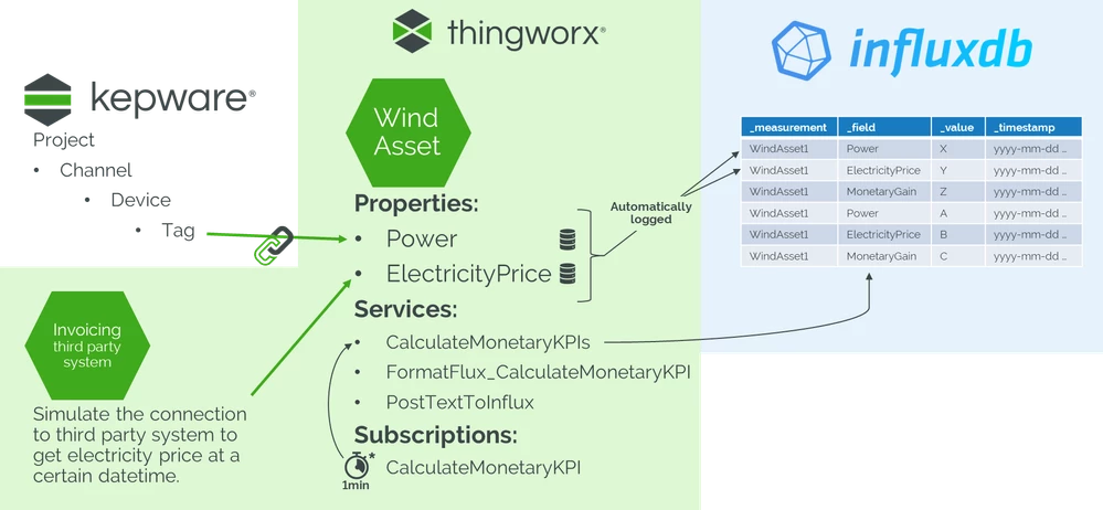

The following InfluxDB usage has been developed for an electricity energy provider.
Technical Context
Kepware is used as a source of data. A simulation for Wind assets based on excel file is configured, delivering data in realtime.
SQL Database also gather the same data than the simulation in Kepware. It is used to load historical data into InfluxDB, addressing cases of temporary data loss. Once back online, SQL help to records the lost data in InfluxDB and computes the KPIs.
InfluxDB is used to store data overtime as well as calculated KPIs.
Invoicing third party system is simulated to get electricity price according time of the day.
Orchestration of InfluxDB operations with ThingWorx

Due to the fact relevant numeric properties are logged overtime, new KPIs are calculated based on the logged data. In the following example, each Wind asset triggered each minute a calculation to get the monetary gain based on current power produced and current electricity price.
The request is formated in ThingWorx, pushed and executed in InfluxDB. Thus, ThingWorx server memory is not used for this calculation.

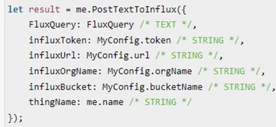

Url, token, organization and bucket are configured in the Persitence Provider used by the ValueStream. We dynamically get it from the ValueStream attached to this thing.
From here, we can reuse it to set the inputs of two other services using “MyConfig”.

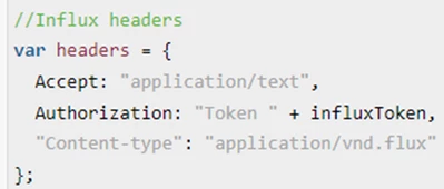

Pretty straightforward script, the idea is to have a generic script to post a request. The header is quite original with the vnd.flux content type
Url needs to be formatted according InfluxDB API

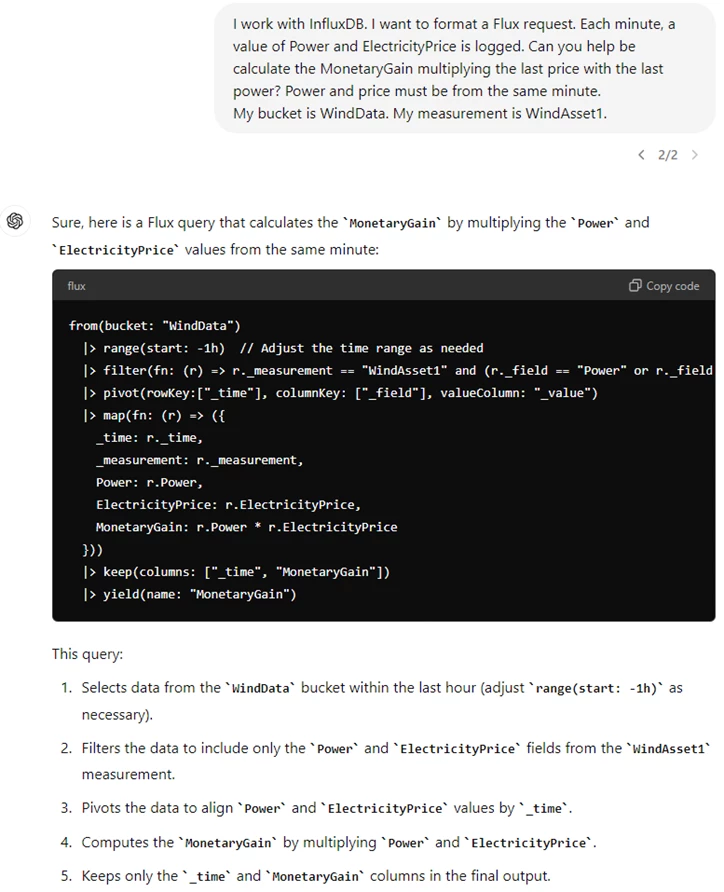

It was the first time I was in touch with Flux script, so I wasn't comfortable, and I am still far to be proficient. After spending more than a week browsing through InfluxDB documentation and running multiple tests, I achieved limited success but nothing substantial for a final outcome.
As a last resort, I turned to ChatGPT. Through a few interactions, I quickly obtained convincing results. Within a day, I had a satisfactory outcome, which I fine-tuned for relevant use.
Here is two examples of two consecutive ChatGPT prompts and answers. It might need to be fine-tuned after first answer.
Right after, I asked to convert it to a ThingWorx script format:
In this last picture, the script won’t work. The fluxQuery is not well formatted for TWX. Please, refer to the provided script "FormatFlux_CalculateMonetaryKPI script.docx" to see how to format the Flux query and insert variables inside.
Despite mistakes, ChatGPT still mainly provides relevant code structure for beginners in Flux and is an undeniable boost for writing code.
