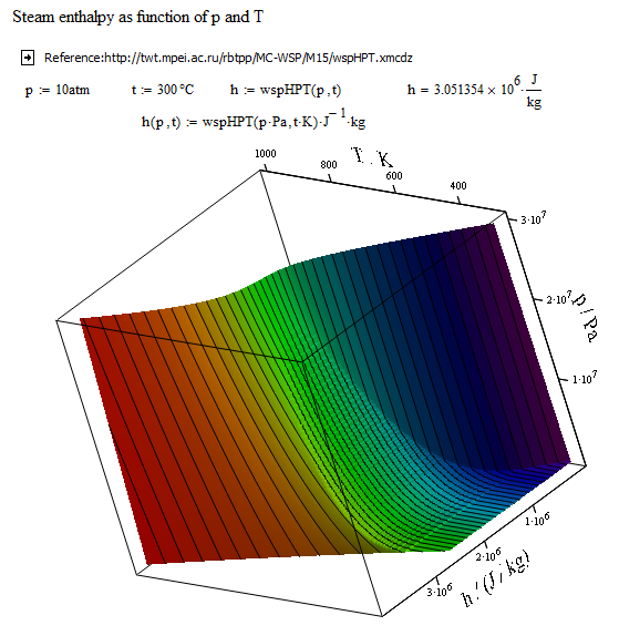

If you need a steam enthalpy as function of p and T you can use a cloud function - see please the picture and the attach:

Dear Valery,
Thank you very much for your response. Indeed, it is a steam enthalpy function I need. I will have a look at the one you have sent me and see how it works. I didn't know about the cloud functions. Are there functions for "everything" in the cloud ?
//Rasmus
January 28, 2013
Rasmus Friberg wrote:
Dear Valery,
You welcome!
You can also use the WaterSteamPro - see www.wsp.ru
See please http://twt.mpei.ac.ru/ochkov/WSPHB/Web-function-Power-Eng.pdf
I hope in future but now I have a lot of them for Power Engineering.
