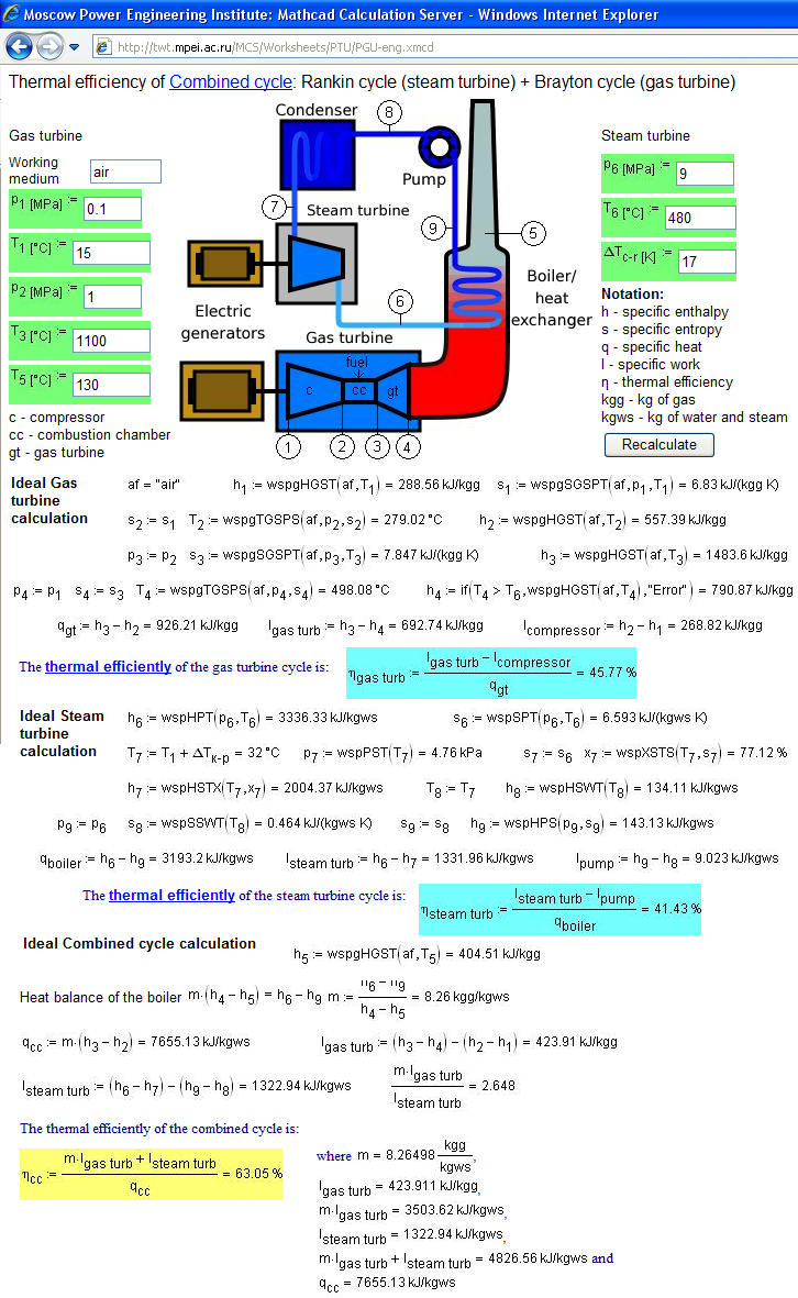

I read an example on combined cycle recently. The calculation procedure considers the effect of fuel composition on thermal efficiency. when I did this calculation following the example, I found that the final efficiency would be greater than 100% if air surplus coefficient was large enough. Could anybody here tell me the reason?
p.s. I use trial and error method to estimate some parameters in the worksheet, but it is manually, can I do it automatically in mathcad?

May be this
http://twt.mpei.ac.ru/MCS/Worksheets/PTU/PGU-eng.xmcd
will be interecting for you.
See the screenshot of this Mathcad-Web-Sheet:

I think this answer will be more helpful to my confusion than your last answer. what confuses me is when I change the air surplus ratio to a higher value than what is given in this example, the efficiency based on the lower heating value of the fuel will exceed 100%. I m not sure whether it is right in this book.
