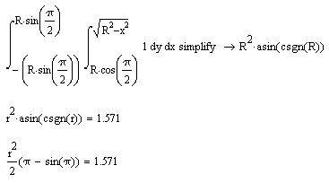

As you can probably detect my integration skills are not very sharp but what should be a simple problem has a certain subtly that escapes me. Can someone help.

Thanks guys but I don't think either answer is what I am looking for? What I am trying to figure out is the general equation for the circular segment i.e. a symbolic result that is identical to Wikipedia. For example, how does Wikipedia arrive at the result R^2 / 2 (angle-sin(angle)) formula?
My example gave you the answer you asked for.
Also see below.
Mike

Something like the attached?
Mike

You might have confused theta and theta/2 - see attached for derivation.
Alan

Thanks guys but I don't think either answer is what I am looking for? What I am trying to figure out is the general equation for the circular segment i.e. a symbolic result that is identical to Wikipedia. For example, how does Wikipedia arrive at the result R^2 / 2 (angle-sin(angle)) formula? For some reason the symbolic results even if one transferring Mikes' numerical result into a symbolic result in MathCad it still seems to produce the incorrect general symbolic result. But maybe further algebraic manipulations need to be done to get the Wikipedia answer?
Regards, Mark
