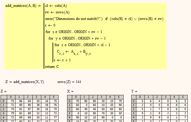

I would like to create a function that add each line of a 12x6 matrix to each line of another 12x6 matrix and return a 144x6 matrix.

The resulting matrix Z I want should be:
If I go from X(12X6) and Y(12X6)
Z1st row = X1st row+Y1st row
Z2nd row = X1st row+Y2nd row
Z12th row = X1st row+Y12th row
Z13th row = X2st row+Y1st row
Z144th row = X12th row+Y12th row
Do you see ?

Here is a quick solution for Mathcad 15 with rudimentary error handling and ORIGIN-aware

It does seem to be working, I will try this out tomorrow...
Thanks a lot Werner

You are welcome.
You should be able to open the sheet with MC14 w/o problems. The question about the version was mainly Mathcad vs. Prime. Any of these can't open the file format of the other.
