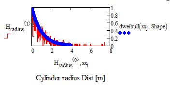

Using Montecarlo to generate random data we would like to use the Weibull distribution and then later a custom function for our calculations. However, we are experiencing some problems which we believe is due to our lack of experience.
The first issue is that specifying different Weibull parameters when used in a Montecarlo does not seem to change the shape of the graph (see Cylinder Radius on Pg 4). The red trend was generated using MonteCarlo with a shape factor equal to 1 defined in the seond column of the Rvals matrix on Pg 3. Changing this value however does not change the shape of the graph away from exponential decay as would normally be expected with the Weibull.
Are we defiing the parameters incorrectly or how do you change the shape for different shape factors inside the Rvals matrix.

Hi Barend,
I'm not actually sure what you're trying to do yet, but a quick check on your worksheet seems to indicate that the Weibull shape factor does have an effect and gives me the shapes I'd expect from that distribution.

March 11, 2014
We managed to simulate the Weibull as well. No problem. The problem is when trying to force the Weibull or a custom function in the MonteCarlo, then it does not work as expected (see our model). We would like to understand how to apply the MonteCarlo for this. As per Alan's reply it seems as if the built-in MonteCarlo does have its issues.
March 11, 2014
I think the in-built montecarlo function is awkward and inflexible. I prefer to write my own routine. See attached for a couple of simple examples: one using a triangular distribution and the other using a three-parameter Weibull.
